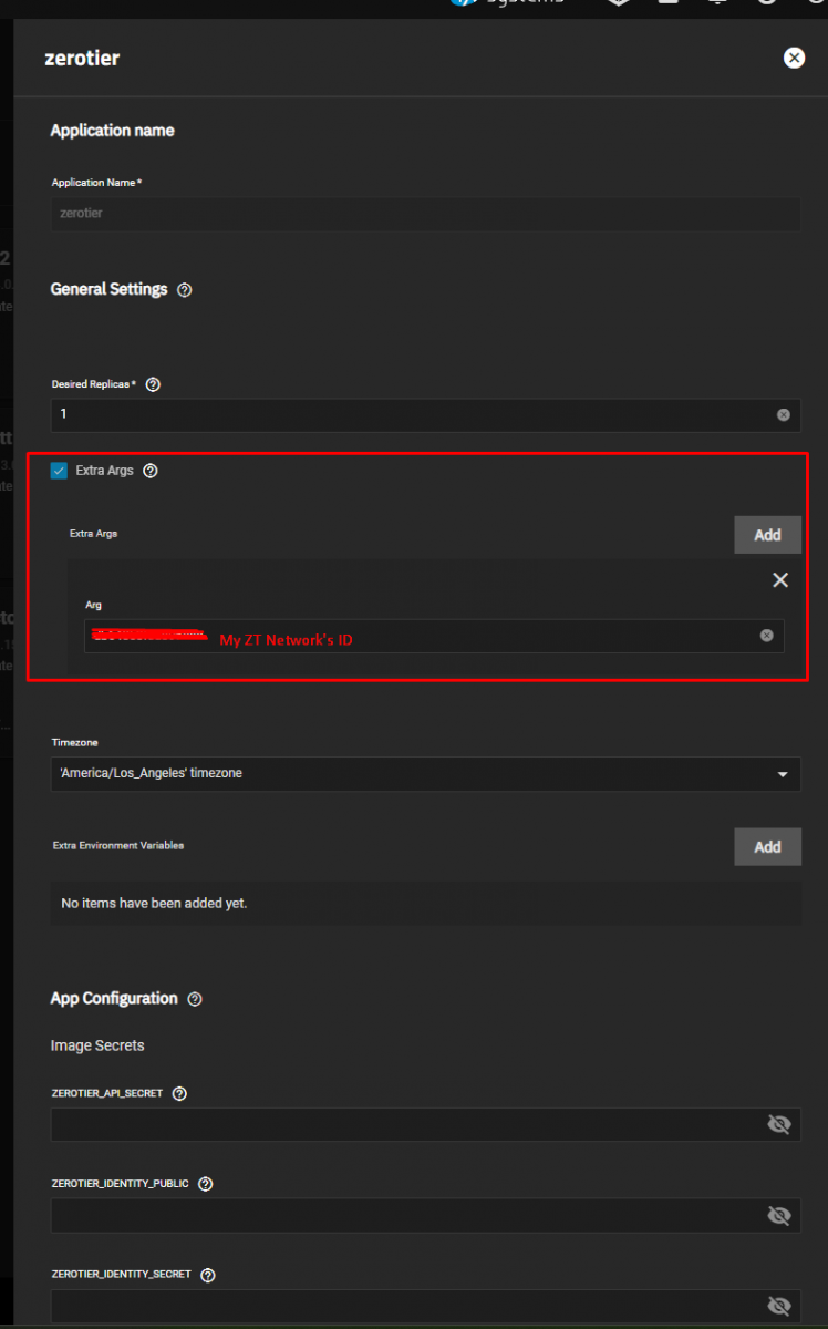

I imported the TrueCharts Catalog and installed it throught it. You can add the key of your ZeroTier network in the ''extra args'' tab and then, once the docker app is done deploying, you will see the server in your network. Easier than dealing with the CLI and works just as well.

thank you for the help, the "extra arg" tip that you gave me works flawlessly, i dont know where did you get it from because the documentation in the truechart website is empty about zerotier, nevertheless i'm not able to make it work, i read in other sites that i need to allow NET_ADMIN and SYS_ADMIN along a variety of tips that doesnt match my process... long story short, i couldnt find a clear explanation how to install zerotier on truenas scale. guess i will have to stay in truenas core still.
Nov 13, 2022
39

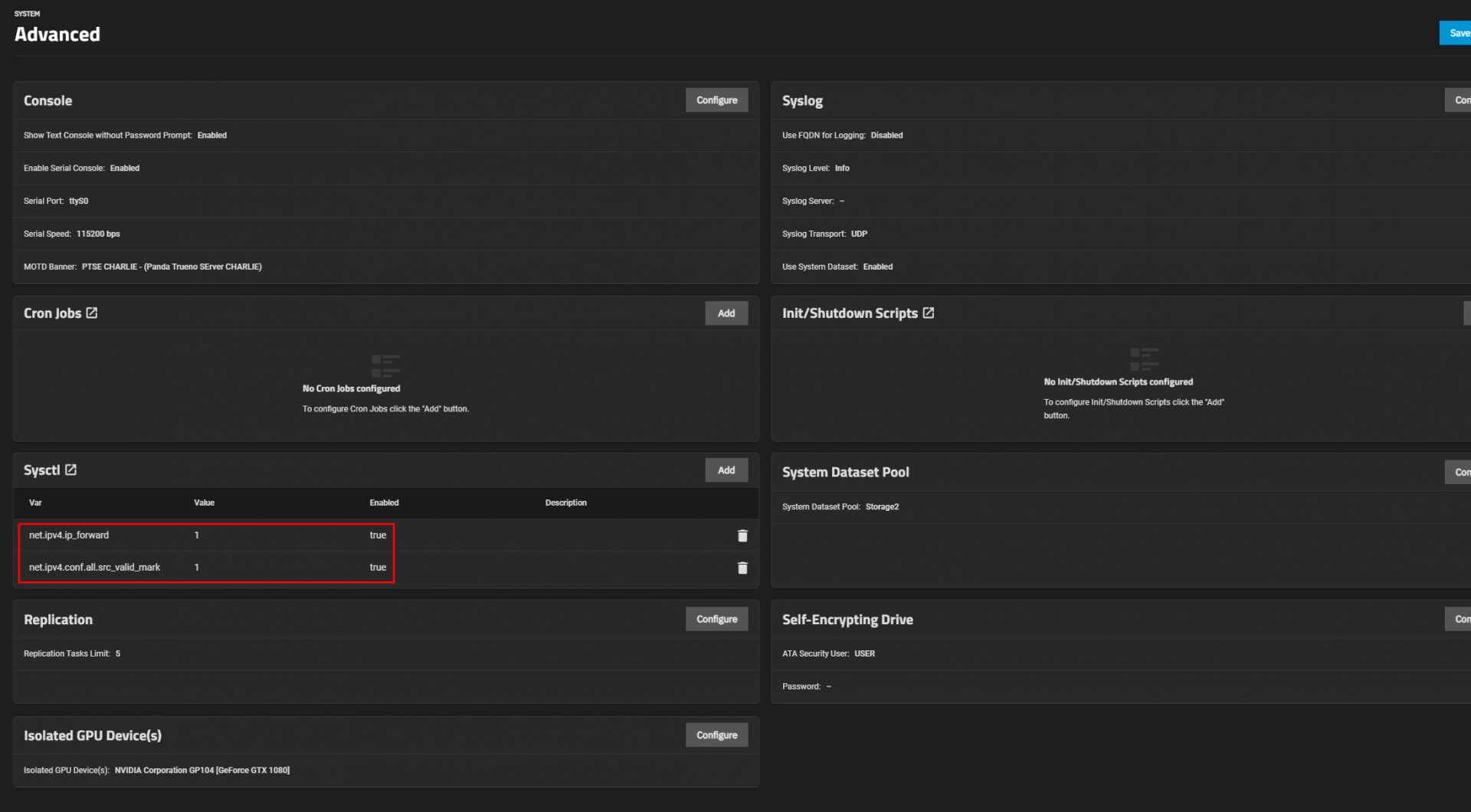

Glad it worked for you. I actually didn't know at first where to put it so I tried extra args. That's how I got it to work. Also for ZT to work properly you need to enable ''Host-Networking (Complicated)'' under expert config and add those two in systemctl:
net.ipv4.ip_forward | value = 1
net.ipv4.conf.all.src_valid_mark | value = 1
Doing so allowed me to fully utilize ZT.
I can access my SMB drives through ZT / access my 3 server when I'm not home
I made an account just to thank you @The_Panda_Trueno This worked perfectly!

What "extra arg" did you set?
Nov 13, 2022
39
I simply added the Network ID as so in the picture below:
My bad for the late answer, I got pretty busy.
Also keep in mind that some steps are needed to make it work. I would suggest to scroll back up for all the settings to apply.

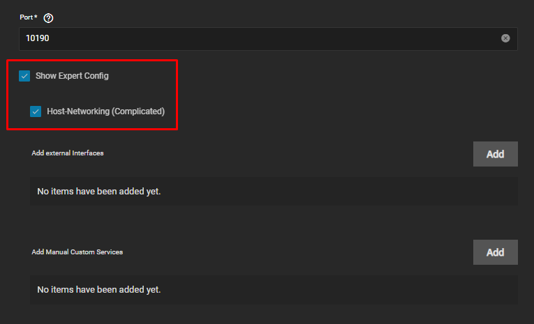

This thread is the closest I've come to getting this to work. Here's where I'm at
I can add my server to zerotier and other zerotier members can now successfully ping my server, but I can't ping any of them from the server. I also can't ssh into the server via the zerotier IP or access the web gui.
The only thing I can think of is that no matter how hard I looked, I couldn't find anything resembling the "Host-Networking (Complicated)" option we're supposed to check when setting up the truecharts LXC. I'm running v1.10.3_5.0.5. Is there a way to manually enable that?
Pieces of this are new to me. Maybe there's something obvious I'm overlooking that was implied that I didn't pick up on?

I am in the same boat, I saw the option to add the NIC dropdown menu but adding that as DHCP didn't do anything, and making it static to the IP of my truenas made me unable to access the nas at all until i disabled access on ZT web settings.
I did port forwarding, i even set it in DMZ temporarily and still couldn't connect to it. I was able to briefly ping it but couldn't access webgui or shares. I can't remember what settings i changed on the router or ztier on truenas settings but i can no longer ping it. :(
I can easily access my main truenas at a different location but that's likely because it's being accessed via opnsense controlling my network there.
I've only tried comcast locations so far but i don't think that has anything to do with it (hopefully)

''Host Network (Complicated)'' is no longer an option since TrueCharts got updated.
I also cannot ping the WebUI anymore.
The only person that could possibly tell us what is the replacement of this option is @truecharts themselves I believe.
This issue is not router-related or anything. It is related to the app parameters itself.
