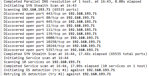

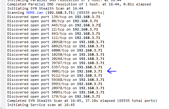

1 issue i still don't how to solve it.
how to configure truenas scale/nextcloud server to open port 9001 in zerotier ip.
coz i can't access the nextcloud server if using zerotier ip, could not found the host.
try scan the truenas ip port, found that 9001 only open for local ip, not open with zerotier ip.
any configuration to set ??
i already add zerotier at nextcloud config.php

root@truenas[~]# netstat -r
Kernel IP routing table
Destination Gateway Genmask Flags MSS Window irtt Iface
default OpenWrt.lan 0.0.0.0 UG 0 0 0 enp2s0
172.16.0.0 0.0.0.0 255.255.0.0 U 0 0 0 kube-bridge
192.168.3.0 0.0.0.0 255.255.255.0 U 0 0 0 enp2s0
192.168.193.0 0.0.0.0 255.255.255.0 U 0 0 0 ztr2qyexzy
root@truenas[~]#
