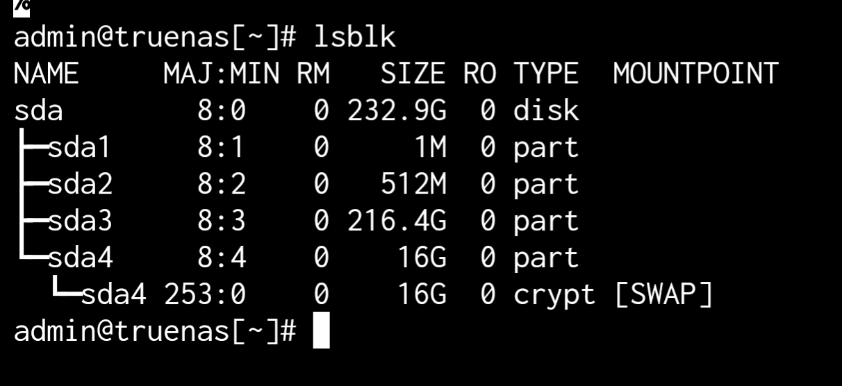

Do they show under Storage -> Disks? If not, at the shell, what's the output of lsblk?
I don't think so. Please see attached

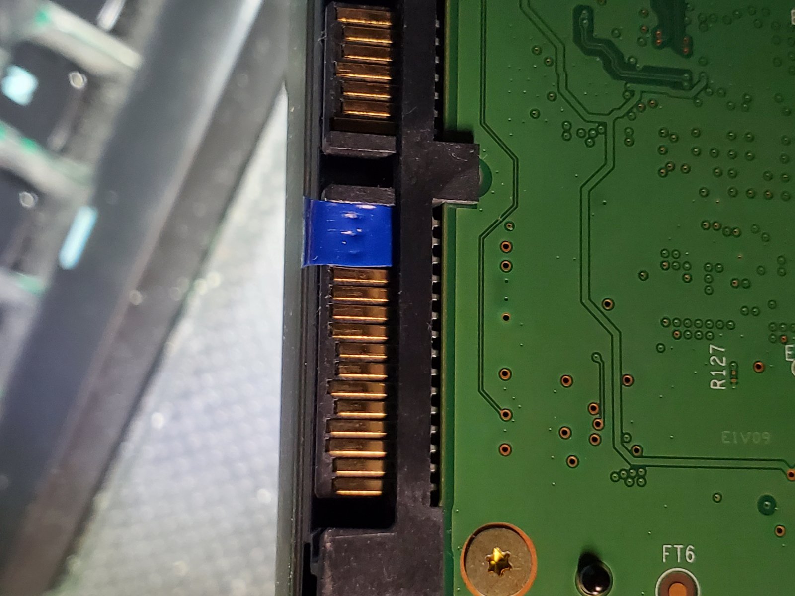

So, I tried a different set of old HDD's that I had laying around. They all worked. So, it might be the PWDIS issue. Not sure how to fix it because I have a molex to SATA cable but my psu doesnt support that.
kamalov
Dec 14, 2022
43
I can't endorse it personally, but some users have applied non-conductive tape to the pin in question. At least you seem to have identified the issue.
I just tried it with 2 different types of tape and it didn't work. Any other ideas?
Oct 22, 2019
3,641
Did you try covering pins 1 through 3?
It's what I did for a couple shucked drives, and it worked as expected. The guides tell you to "cover pin 3", but this is tricky to do with precision, and to make sure the tape doesn't shift or curl. However, it's easier to cover pins 1 through 3 with a wider cut of tape, and still get the same result.
Just make sure you don't cover pin #4. Precision is key. I used Kapton tape.
kamalov
Dec 14, 2022
43
I used electric tape as seen in this photo to cover the 3 pins.
