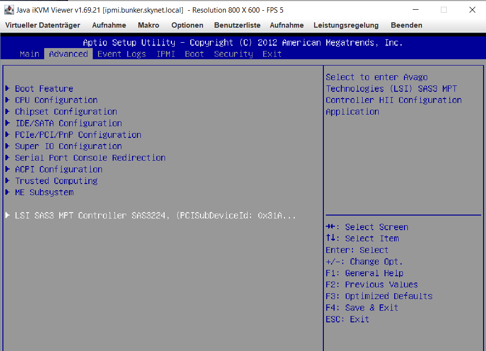

I am able to access the Controller BIOS from within the mainboard bios.
The picture below shows the current firmware version. if p16 == Version 16 an update is probably a good idea :)

where? -> in mainboard bios there is a section for the controller:

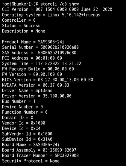

i dont have mprutil on my system (can i install it?) but i got the controller firmware specs via storcli:

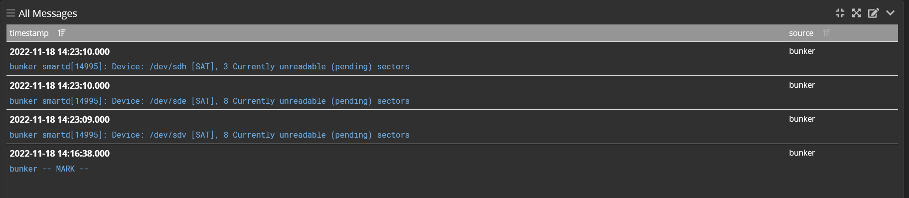

sde and sdh are not even in a pool. sdv is part of my pool. but... is a single drive that has unreadable sectors enough to freeze the system?
