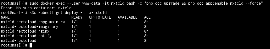

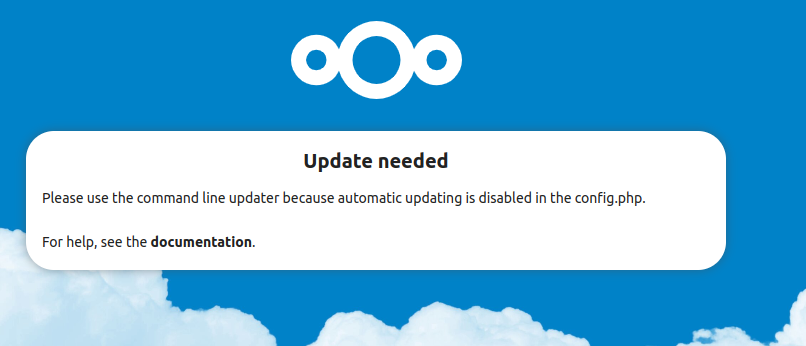

i already follow the step backup n restore than show this message
how to solve it??
follow guide from https://github.com/nextcloud/all-in-one/discussions/1787 still no solve
