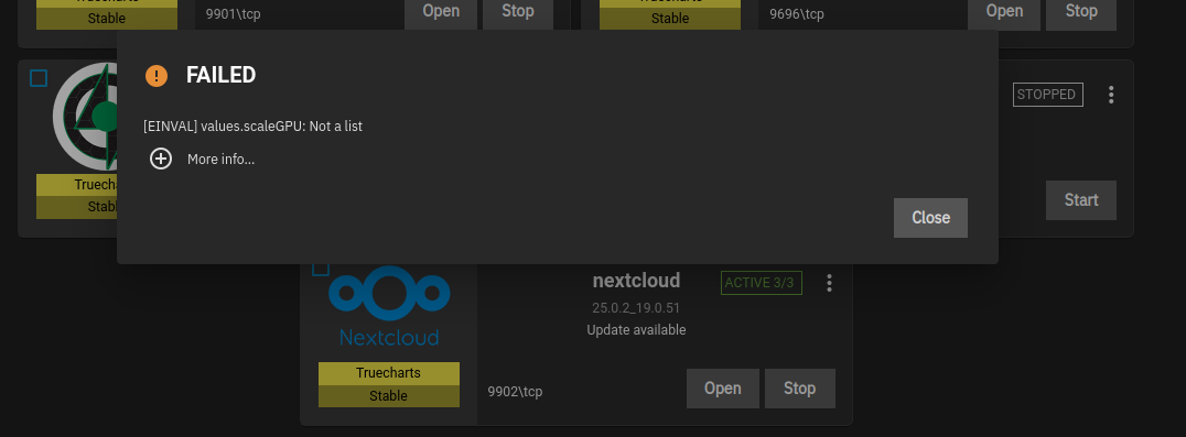

after long time waiting new version, now can't do upgrade always show error
any idea how to solve this issue? only upgrade nextcloud showing issue, upgrade other package no issue.
truenas version TrueNAS-SCALE-22.12.3.1

That error appeared before on every truecharts app when you wanted to upgrade. The only solution is to reinstall it.

The truecharts version got updated with their new common chart and therefore needs to be re-installed, you can't update as is.
You have to backup your nextcloud database, delete the old app, reinstall the new version and restore your database from the backup.
Heres the migration guide from the truecharts homepage

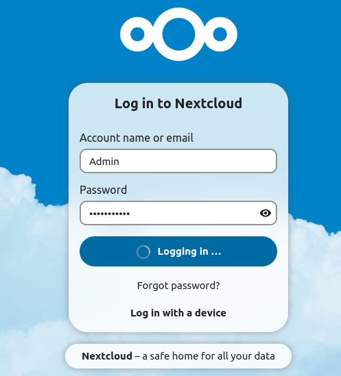

fresh install new version, still can't login don't know why, try 2 browser still show same issue.
but i don't have issue with old version.

please test with ingress on,
just today i found i don't have issue if ingress off, when ingress on stuck at login

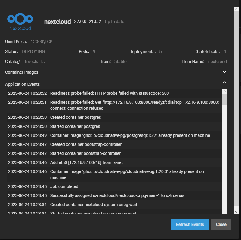

I did a fresh install. I removed the previus install, I leaved everything on default parameters and still I get this error:
The deployment stucks at 4/7. How can I slove this? I removed at least 10 times and tried reinstall it.

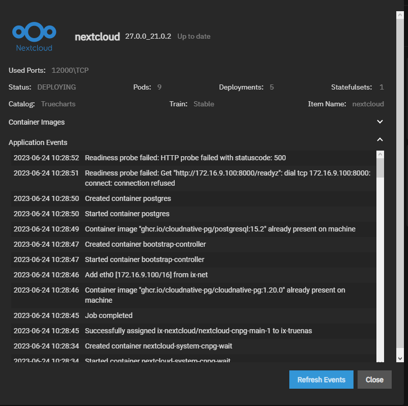

how long u wait? this new version take long time to ready
If stuck u can try restart your nas.

I did many restarts and I was waiting till morning after the last deploy. Now I updated for the newer version of truenas (22.12.3.1) but no luck, I was on 22.12.3.
But I tried to install the default nextcloud from truenas, not from truecharts and the result is the same:
2023-06-24 12:19:43 Back-off restarting failed container
2023-06-24 12:17:55 Readiness probe failed: HTTP probe failed with statuscode: 500
2023-06-24 12:17:54 Readiness probe failed: Get "http://172.16.0.39:8000/readyz": dial tcp 172.16.0.39:8000: connect: connection refused

Hello!
Now its alive! I fount the problem, I have too complicated admin password with "+!-" signs and it isn't like it. So now its good but I have ingress problems too. Its redirecting to the port 12000, and I can't do anything for it :D... Its a bit buggy yet but I hope its will be good after some debugging.
