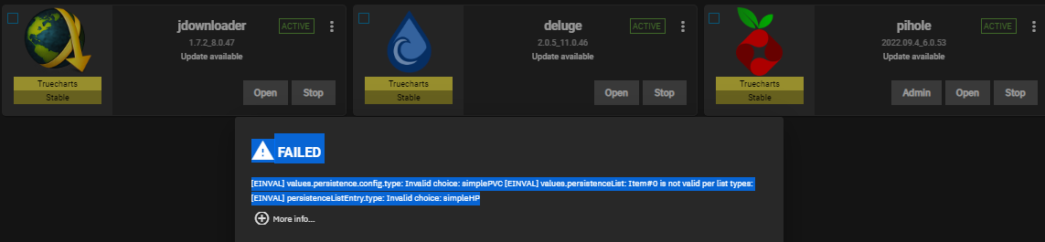

Hi lads,
Did anyone experience this recently? I have been unable to update my applications ever since.
[EINVAL] values.persistence.config.type: Invalid choice: simplePVC
EINVAL] values.persistenceList: Item#0 is not valid per list types:
[EINVAL] persistenceListEntry.type: Invalid choice: simpleHP
Error: Traceback (most recent call last): File "/usr/lib/python3/dist-packages/middlewared/job.py", line 411, in run await self.future File "/usr/lib/python3/dist-packages/middlewared/job.py", line 446, in __run_body rv = await self.method(*([self] + args)) File "/usr/lib/python3/dist-packages/middlewared/schema.py", line 1272, in nf return await func(*args, **kwargs) File "/usr/lib/python3/dist-packages/middlewared/schema.py", line 1140, in nf res = await f(*args, **kwargs) File "/usr/lib/python3/dist-packages/middlewared/plugins/chart_releases_linux/upgrade.py", line 116, in upgrade await self.upgrade_chart_release(job, release, options) File "/usr/lib/python3/dist-packages/middlewared/plugins/chart_releases_linux/upgrade.py", line 266, in upgrade_chart_release config, context = await self.middleware.call( File "/usr/lib/python3/dist-packages/middlewared/main.py", line 1345, in call return await self._call( File "/usr/lib/python3/dist-packages/middlewared/main.py", line 1294, in _call return await methodobj(*prepared_call.args) File "/usr/lib/python3/dist-packages/middlewared/plugins/chart_releases_linux/chart_release.py", line 333, in normalise_and_validate_values dict_obj = await self.middleware.call( File "/usr/lib/python3/dist-packages/middlewared/main.py", line 1345, in call return await self._call( File "/usr/lib/python3/dist-packages/middlewared/main.py", line 1294, in _call return await methodobj(*prepared_call.args) File "/usr/lib/python3/dist-packages/middlewared/plugins/chart_releases_linux/validation.py", line 51, in validate_values verrors.check() File "/usr/lib/python3/dist-packages/middlewared/service_exception.py", line 62, in check raise self middlewared.service_exception.ValidationErrors: [EINVAL] values.persistence.config.type: Invalid choice: simplePVC [EINVAL] values.persistenceList: Item#0 is not valid per list types: [EINVAL] persistenceListEntry.type: Invalid choice: simpleHP

Change from PVC(Simple) to just PVC and hostpath(simple) to Hostpath
Additionally change the PVC size from whatever it is to 999Gi.
That should fix it.
Every Simple service Type has been depreciated.
I also had to change those settings after truecharts did a bigger overhaul of the apps config
That should fix it.
Can confirm this works but I also have to add that I need to change some network type to "Load Balancer" else I can't access the apps.
That should fix it.
Thanks, This has solved my problem!
