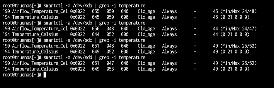

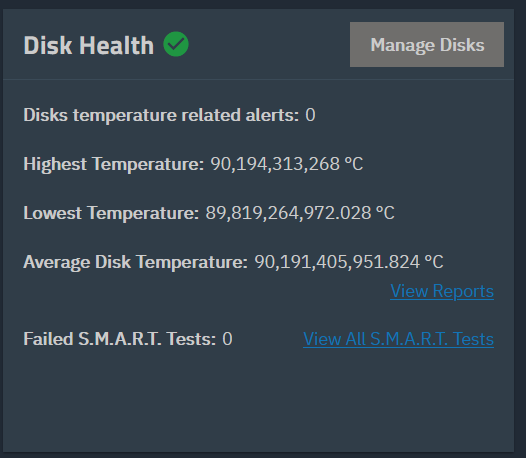

I have a problem with TrueNAS Scale reporting obviously incorrect temperatures.
I ran a command in this post, and it seems to report more plausible temps for the HDDs. So I don't know where the disconnect is.
Rebooting did not help. The best thing I could think of that could create the issue is that I'm running truenas in the recently released Jonsbo N3. It has the HDDs connected to a backplane, before it connects to the motherboard via SATA cables. Could anyone help on fixing this?

It has been fixed with the latest SCALE version. Update and restart the logging graph (sonewhere in system>reporting or similar).

Thank you. I thought to do this after my post but before your reply.
