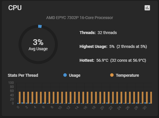

The dashboard isn't working correctly either. All CPU threads have the same temperature:
