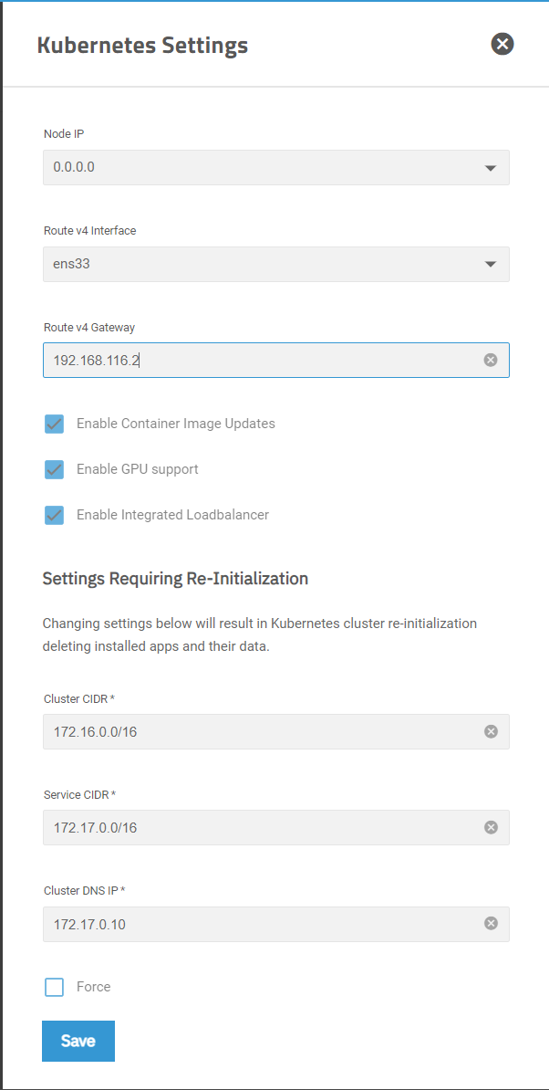

Now I go into apps and add my pool. In the Kubernetes Advanced Settings, I configure the below setting and save. It now displays "Apps Service Running".
1) Route v4 Interface to ens33 (Interface Name)
2) Route v4 Gateway to 192.168.116.2 (Names server or Default Route as both show the same IP in Networking)
See Attached Pic-1

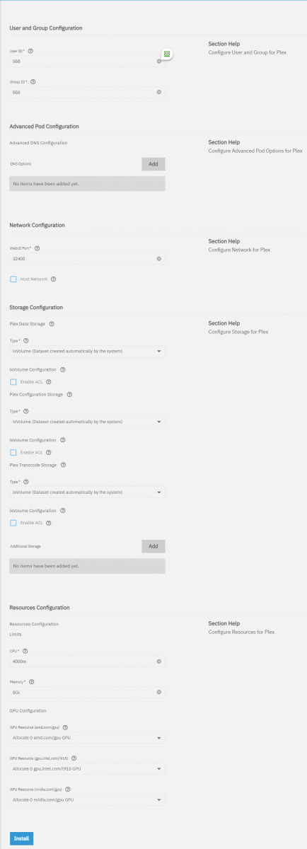

Now I go into Apps and install Plex 2.0.1 and begin to configure.
"Application name" - No Change
"Plex Configuration" - I change "TimeZone", insert my "Claim Token" and change "Image" to "Plex Pass Image".
"User and Group Configuration" - I have left this as is but I'm not sure if I need to add the group ID of "plex_users" and user ID for "michael" in this area.
"Advanced Pod Configuration" - No Change
"Storage Configuration" - I believe this is where I need to setup the four folders above to reach my desired configuration but I need direction.
Note: I have watched several videos online and I have yet to find one that shows the same configuration settings as are in Plex 2.0.1.
"Resources Configuration" - No Change
See Attached Pic-2
Would appreciate any help or direction as to where I could get help on installing :)
