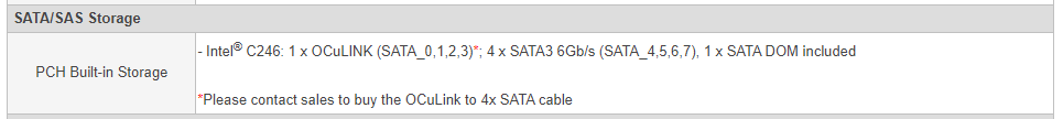

homer27081990
Aug 9, 2022
321
Don't forget this (^) for the mobo
