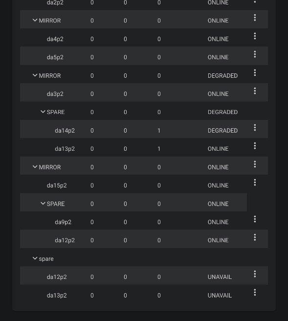

Was moving my server to a rack, had taken all the drives out before moving, was cautious with it, and when booting online everything was fine for a few days.
Then suddenly I got an email while at work, that 2 drives were unavailable and 1 was degraded. I went on and looked and didn't know what to do.
Also it's weird that the two unavailable drives are both spares? But also I see at the top of the picture it shows da14p2 which is listed under "SPARE" which is listed under "MIRROR". So I'm not sure if I'm reading it wrong. I'm very confused.
I don't think it's the drives.
3 drives at once? Can't be. They were bought at different times, and bought used (From a seller which I've had zero issues from all these other like 18 drives from).
Unless it's saying that one drive failed (degraded) and the other 2 are unavailable because it resilvered to them? But why are 2 unavailable then? Just very confused.
So a few hours later I was heading home, I could still access the server.
Then suddenly 10min later between checking it, and getting home. I walk into my room, and the server is off. I pulled it out and the HBA pulled out a little because I didn't have it screwed down and the back of the server slides out from the front because it has rear backplane. So the wires pulled a bit.
I put it all back together, and reseated wires and stuff and it works fine and booted.
I reran a scrub, and the same exact drive shows degraded, and 2 unavailable.
I am not very familiar with diag and not sure where to start, what might be the issue.
I had ran smart tests on the 3 drives and I think they all seemed to pass?
It's a TrueNAS Core, and a Supermicro server with a LSI HBA in IT Mode for reference.

# zpool status -v
  pool: PrimaryPool
 state: DEGRADED
status: One or more devices has experienced an unrecoverable error.  An        attempt was made to correct the error.  Applications are unaffected.
        using 'zpool clear' or replace the device with 'zpool replace'.   see: https://openzfs.github.io/openzfs-docs/msg/ZFS-8000-9P
  scan: scrub repaired 128K in 07:53:38 with 0 errors on Wed Sep 21 07:16:01 202
config:
        NAME                                              STATE     READ WRITE C
KSUM
        PrimaryPool                                       DEGRADED     0     0
   0
          mirror-0                                        ONLINE       0     0
   0            gptid/d7476d46-32ca-11ec-b815-002590f52cc2    ONLINE       0     0
   0
            gptid/d8d6aa36-32ca-11ec-b815-002590f52cc2    ONLINE       0     0
   0
          mirror-1                                        ONLINE       0     0
   0
            gptid/d9a6f5dc-32ca-11ec-b815-002590f52cc2    ONLINE       0     0   0
            gptid/db71bcb5-32ca-11ec-b815-002590f52cc2    ONLINE       0     0   0
          mirror-2                                        ONLINE       0     0   0
            gptid/d8b2f42f-32ca-11ec-b815-002590f52cc2    ONLINE       0     0   0
            gptid/d96847a9-32ca-11ec-b815-002590f52cc2    ONLINE       0     0   0
          mirror-3                                        ONLINE       0     0   0
            gptid/d9fb7757-32ca-11ec-b815-002590f52cc2    ONLINE       0     0   0
            gptid/da1e1121-32ca-11ec-b815-002590f52cc2    ONLINE       0     0   0
          mirror-4                                        ONLINE       0     0   0
            gptid/9fd0872d-8f64-11ec-8462-002590f52cc2    ONLINE       0     0   0
            gptid/9ff0f041-8f64-11ec-8462-002590f52cc2    ONLINE       0     0   0
          mirror-5                                        DEGRADED     0     0   0
            gptid/14811777-1b6d-11ed-8423-ac1f6be66d76    ONLINE       0     0   0
            spare-1                                       DEGRADED     0     0   0
              gptid/1471d6e5-1b6d-11ed-8423-ac1f6be66d76  DEGRADED     0     0   1  too many errors
              gptid/0d56b97d-1e91-11ed-a6aa-ac1f6be66d76  ONLINE       0     0   1
          mirror-6                                        ONLINE       0     0   0
            gptid/47050bdd-1b6d-11ed-8423-ac1f6be66d76    ONLINE       0     0   0
            spare-1                                       ONLINE       0     0   0
              gptid/4710dd39-1b6d-11ed-8423-ac1f6be66d76  ONLINE       0     0   0
              gptid/0d48d4ab-1e91-11ed-a6aa-ac1f6be66d76  ONLINE       0     0   0
        spares
          gptid/0d48d4ab-1e91-11ed-a6aa-ac1f6be66d76      INUSE     currently in use
          gptid/0d56b97d-1e91-11ed-a6aa-ac1f6be66d76      INUSE     currently in use
errors: No known data errors

I am unfourtunately still having troubles with this.

I am curious though, wouldn't this cause more than one drive to have issues if it was an HBA cable?
And once more, I am still confused why the two spare drives show "UNAVAILABLE"?
And then one drive shows "DEGRADED"
And why in the picture, it shows the degraded one under a SPARE dropdown which is nested under an actual mirror vdev?
I only have 2 drives in my system that should be acting as spares. Not 4.
So I'm very confused on how it's presenting itself.

Looking this over now that I have a little time, I'm still a bit confused which drive I'm moving.
I don't understand, I only have 2 spares setup in this system.
It shows mirror 5, and it shows spare 1 is degraded.
But it lists 2 drives?
And it also shows 2 spares at the very bottom, and are listed as currently in use.
I just am failing to understand how it is displaying it, and which drive I need to move?
If I had to take a guess, I have to move gptid/1471d6e5-1b6d-11ed-8423-ac1f6be66d76 DEGRADED 0 0 1 too many errors
But why is it listed as a spare? Is it saying one drive died, it put a spare into that slot, and then that spare one is also having issues? That doesn't seem right to me.

Arwen
May 17, 2014
3,611
It's more or less obvious. The 2 spares are "currently in use", so those 2 were mirrored against a failing drive. For some reason mirror-6 is fine, so I would ignore it for the moment.
Replace the DEGRADED item is "mirror-5", "spare-1", which is NOT your spare.

Mirror implies 2 drives. Are you saying both drives in mirror 5 failed?
If 1 drive fails in a mirror, I would expect one spare to fill it. If another drive in another mirror or the same fails, I would expect the other drive in the spare to fill in or that failed.
Is this not how it works?
Anyways, my question still remains because of my confusion.
In mirror-5, spare-1, it is listing TWO drives. Plus one directly above it outside of "spare-1" Why? It makes it seem like there are 3 drives in mirror-5, when there only are actually 2.
And can you point out the gptid of the failed drive so I can maybe understand better?
Not sure why this is so confusing to me, thank you.

No, I am NOT saying both drives in "mirror-5" failed. What ZFS does for hot sparing, is create a temporary sub-mirror of the failing drive, in this case "spare-1":
The failing disk is the second to last line above. It is clearly listed as DEGRADED. Your spare is the bottom line, which I can tell because you gave me the GPTIDs of the 2 spares. And this spare is listed as ONLINE, meaning GOOD.
As I said, ZFS sparing creates a sub-mirror of the failing drive and the spare drive. It may appear confusing, but the intent is to allow you to either replace the failing disk, (see manual for how to do that). Or remove the failed disk, causing the hot spare to become a (semi-)permanent part of your pool.
You have the GPTID of the 2 spares from your prior listing:
Those show also show you which drives are the spares in the "mirror-5" and "mirror-6". It also helps they are ONLINE, meaning GOOD, in the "mirror-5" and "mirror-6".

isopropyl
Jan 29, 2022
159
Ok so I took a gander and presumed it was simply the drive that failed, and not an issue with the backplane or cables.
I powered down the server, took the old drive out, and popped in a fresh drive and booted up.
I do not see it resilvering. In the web gui it shows that disk as N/A under the "Pool" category.
And it seems to notice the gptid has changed though.
What step did I miss for getting it to be added into the pool and resilver? Do I just need to run a scrub or something?
#zpool status -v

Also noticed new notification
CRITICAL​
Pool PrimaryPool state is DEGRADED: One or more devices could not be opened. Sufficient replicas exist for the pool to continue functioning in a degraded state. The following devices are not healthy:
  • Disk HITACHI HUS72604CLAR4000 K4K7KU5B is UNAVAIL
  • Disk HITACHI HUS72604CLAR4000 K4K6EM8B is UNAVAIL
  • Disk HITACHI HUS72604CLAR4000 K4K9SNYB is UNAVAIL

It most certainly does not. Mirrors are a minimum of two drives, but can be three or four (or more). Even a single disk shares characteristics with a mirror in that a second drive can be attached alongside it, converting it to a two way mirror.
Yeah I understand that, I meant it implied minimum of two drives sorry. Had typed it up quickly.
Arwen
May 17, 2014
3,611
TrueNAS & it's implementation of ZFS does not magically start re-silvering when a disk in a slot is changed out. Use the instructions in the manual for disk replacement.
There can be other reasons why a new disk is inserted. Further, ZFS does not really care which slot a pool member is in. In fact, a disk can change both slot and even controller.
To be fair, this does make things clumsy at times. I've worked with some hardware RAID controllers that just recognized a replacement disk, and if big enough, started re-syncing immediately.
