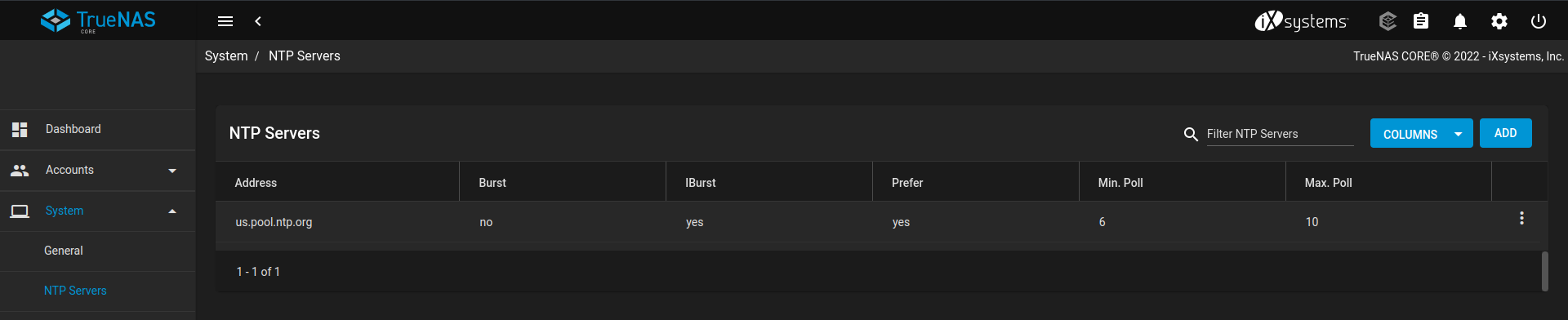

I've had multiple issues with the default NTP servers that TrueNAS Core uses (i.e, freebsd.pool.ntp.org).
Under System -> NTP Servers, I only use us.pool.ntp.org, and I've been happy ever since.
The same is true for a friend's TrueNAS server that we built for them. Same issues with the default NTP servers. We deleted them, then added us.pool.ntp.org as the only server to use. No problems ever since.
EDIT: Obviously if not in the United States, use what is applicable for your location.
