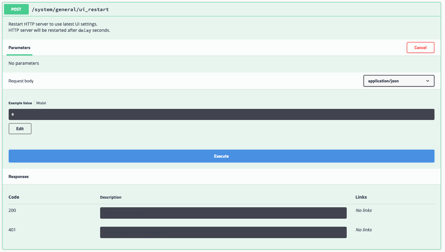

workaround at present isn't ideal requiring a server reboot to restore encrypted communication after a certificate is installed.
It could be more readily worked around; service nginx restart should do it without any other interruption to services on the machine. And updating the script to work with -U3 shouldn't be hard--but if I want it to work with both -U3 and prior versions (which I do; I haven't updated my main system to -U3 and now think I'm unlikely to), that's going to take a bit more thought. It would no doubt help if my familiarity level with Python were somewhere above "banging rocks together."
But the bigger issue, I think, is:
  • It's a breaking change in the API
  • It happened in what should be a bugfix/maintenance release
  • It's undocumented (the official TrueNAS documentation hub still says to use the GET method, or at least it did this morning), unless you look at the documentation that's internal to the product--where all it gives you (once you find it--it isn't exactly the easiest thing to navigate) is this:
  • There was absolutely no warning of the change. I just went line-by-line through the changelog, and it just isn't there. The closest I saw was this one:
    But when I follow the link to the Jira issue, I don't see any discussion, comments, or anything else that would tell me that the method for this endpoint is changing. Even if I click through to the PR, I don't see it, though it's certainly possible I'm failing to understand something that would be evident to someone who actually knew Python
Now, the change in the behavior is a good one--under -U2.1 and prior, the response to the system/general/ui_restart call was immediate--the UI restarted immediately, breaking the connection, and causing a connection error. That's actually the condition my script tests for to indicate success--which is more than a little counterintuitive. To accept the request, return a "success" status, delay a few seconds, and then restart the UI (which is what it's intended to do now in -U3), is much better behavior. I don't know why they felt the need to make the delay configurable, or if that's what necessitated the change from GET to POST, but again, the overall change in behavior is positive.
But positive change or not, iX published and documented an API. People integrated with it. And they broke it, deliberately, in a bugfix release, without a word of warning to anyone or a scrap of documentation.
Thanks Dan, I think it's an example of a bugfix causing problems. There was no intention of an impactful change, but there are unintended consequences of even a minor improvement.
Someone in the community justifiably didn't like the previous behavior. It was fixed. However, its clearly possible that a script may have assumed the previous behaviour.. even if it was worse.
The bug is here: https://jira.ixsystems.com/browse/NAS-109435
It was reported, but the consequences were not guessed. I added a note to the bug page. However, anyone experiencing the issue should update their scripts with the new behaviour. It's better that we don't revert back again.
14,654
It "assumed" nothing--it followed the documented method to use this API endpoint.
Then why change the method for this endpoint? There was no need to do that, just as there was no need to accept a parameter for the delay time. When that endpoint previously (through -U2.1) required the GET method, and now it requires POST, how could that not be an impactful change, and how could it not be obvious that it would be such? It pretty well guarantees that anything that used that endpoint is going to stop working. It breaks the bug reporter's script, just as surely as it breaks mine.
There are two distinct issues here:
  • Until this change, a call to ui_restart immediately restarted the UI, breaking connection. Now, it returns a success code, waits a few seconds, and then does the restart.
  • Under -U2.1 and prior, this endpoint required GET; now it requires POST
The former, standing alone, would have broken my script--I test for that connection error to indicate success (if the connection failed, then the UI restarted). I have no problem accepting that it wouldn't be apparent to your devs that this is a breaking change; looking for a failed connection to indicate success is kind of weird (even if it was necessary at the time). And despite it breaking my script, I agree (as I said above) that this behavior is better; so far as it goes, I'd consider this a fix to an API/middleware bug, and the problem with my script would result from my assuming the previous buggy behavior.
What I can't understand or accept is that the consequences of the second bullet weren't obvious--again, how could they not be? If the endpoint formerly required one method, and now it no longer accepts that method but requires a different method, how could that not break every single thing out there that uses this endpoint? And the frustration is compounded by the fact that there was just no reason to do it. Even if changing to POST was needed in order to accept a parameter for the length of the delay (and I don't know one way or the other if that's the case), nothing in the ticket asked for that--a hardcoded n-second delay (for some reasonable value of n) would have satisfied the request.
Sure--and deal with yet another instance of "iX can't figure out how they want their software to work." Sure, it's easy enough to change session.get to session.post. It's almost as easy to change it to expect a 200 rather than a connection error. It's a little harder to change it to "do X for version A and later (until it's changed again), but do Y for version B and older." Maybe better would be "try GET, if it returns 405, try POST."

@danb35 That's a very reasonable criticism. It was a mistake on our part not to anticipate the potential negative consequences of the improvement.
We'll ask the team to review (and document) any API bug fixes more carefully. @Kris Moore
After an internal meeting, we are exploring making the API respond in both ways in U4. So it would behave similarly to the old GET, but also enable the new POST model. I assume that would be OK with everybody impacted?
14,654
It'd be fine by me. I've updated the script to try POST, if it returns 405, try GET, and it's working with -U3, -U2.1, and 11.3-Usomething. When it does GET, it still expects the connection error as an indicator of success (which is how it works with -U2.1 and earlier), but since I'm now doing POST first and expecting a 200 status, changing the behavior on GET shouldn't further impact me.
