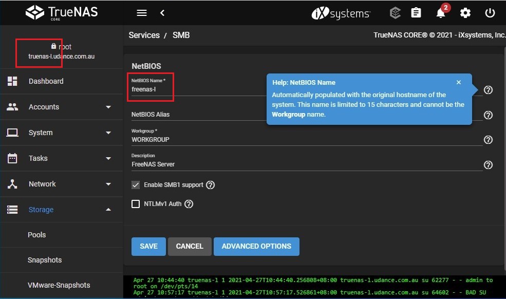

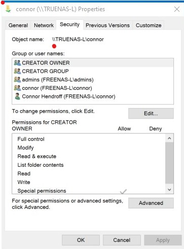

I've recently transitioned from FreeNAS 11.3-U5 to TrueNAS 12.0-U3 on core servers. FreeNAS servers had the prefix freenas in the hostname e.g. freenas-l. It made sense to change the hostnames to use the prefix truenas instead e.g. truenas-l. I have since noticed that the original hostname is still referenced when ACLs are viewed from Windows clients and both user and group SIDs are translated to friendly names. I suspect that some Samba magic is required on the TrueNAS servers to have the SIDs use the updated hostname instead, but I'm not sure the best way to proceed from here?

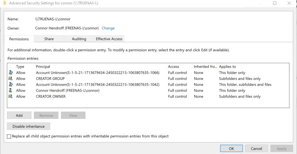

Checking the Windows ACL this time, I note that group SIDs are not being translated to friendly names. It appears the earlier SIDs are still being referenced.
Rolling back returns the previous behaviour.

If you look at the screenshot in the OP, you'll notice this is not the case for the user SID.

One other observation. The SMB service in the TrueNAS UI shows the NETBIOS name as freenas-l. The help though does (correctly? unless I'm misinterpreting this) state that this is the original hostname of the system. I'm not sure if this has any bearing on what I'm observing with the Windows ACL.

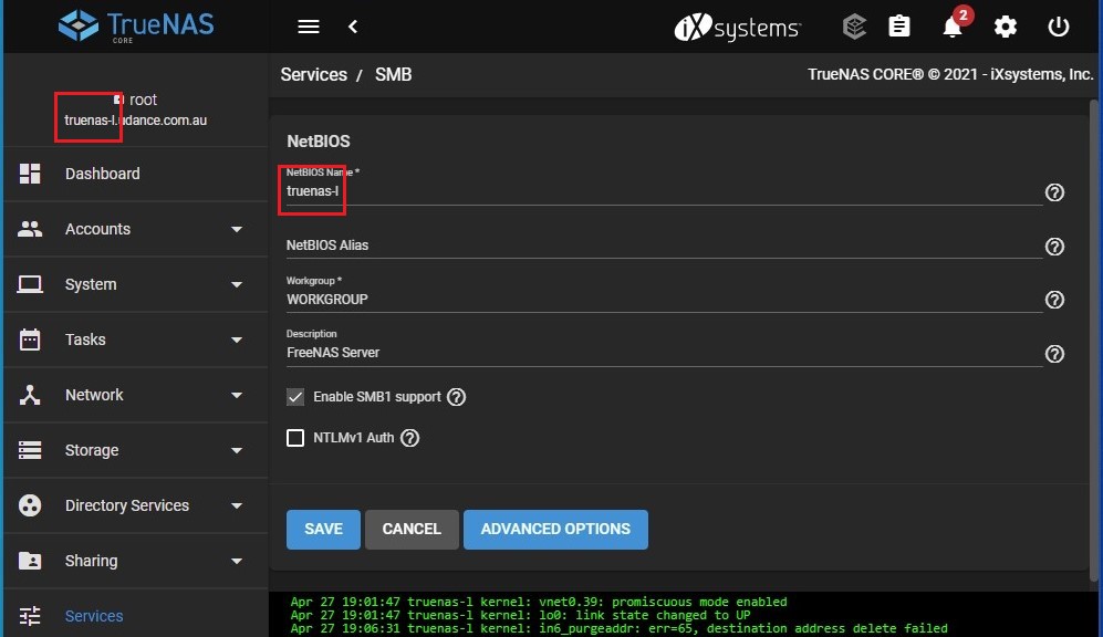

Right, the mystery is solved. These are the steps I needed to execute to fix the SMB mappings when changing hostname on a TrueNAS server.
1. Match the NetBIOS name to the hostname.
2. Regenerate the group mappings (see post #3 above).
3. From the TrueNAS UI, restart the SMB service.

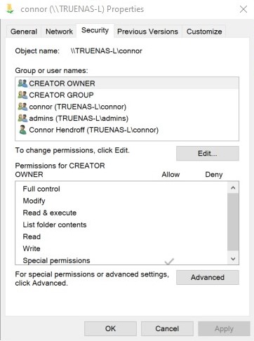

Windows ACLs now show the correct friendly names e.g.
Thanks, @anodos for the group mapping hints.
