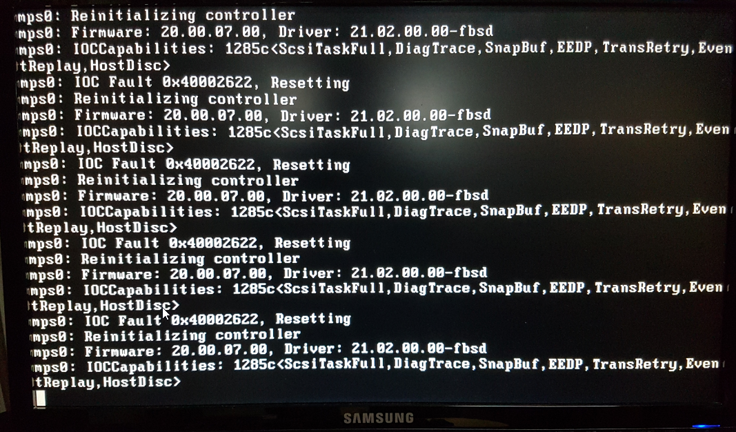

I had something like this happen to one of my servers, where the backplane died, and the server would no longer boot with the backplane connected. It ended up the backplane got fried when the power supply went south, so I had to replace both to get the server back up. Your data should still be safe, but you'll need to systematically check what works with various parts disconnected.

Thanks for that, here goes that long process or testing everything

perhaps the process of rebooting exposed a failing hardware component ..

Just apply the update and discover this after the reboot.
I have a backup of the config but I am not sure what do do right now...

Rebooting to 12.0-RELEASE solved my exact same problem, its something broken in -u1 with LSI drivers and Supermicro expander backplane it seems

I looked up a couple of FreeBSD posts and the issue seems to have been either (a) firmware needs to be upgraded or (b) there is a hardware fault. Of course, this does not rule out the FreeBSD driver - the articles are a little old.

20.00.07.00 is the latest firmware public available for LSI SAS2 HBA cards.

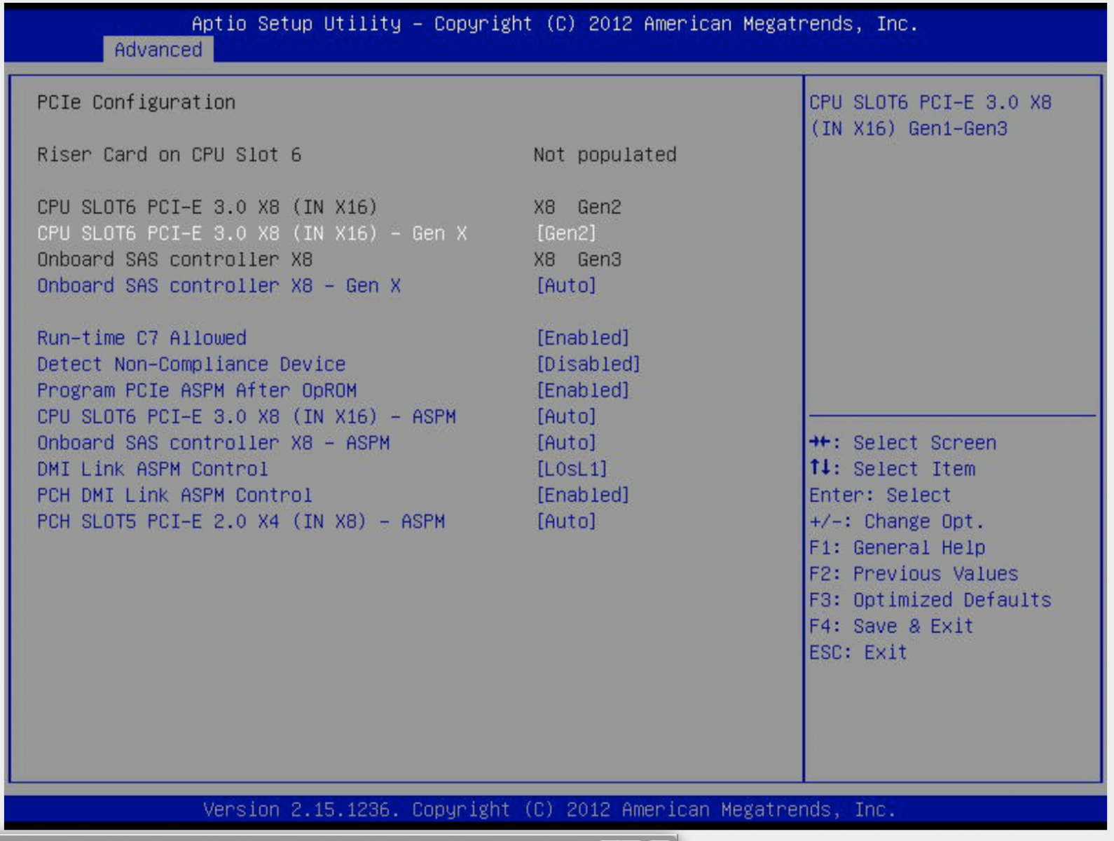

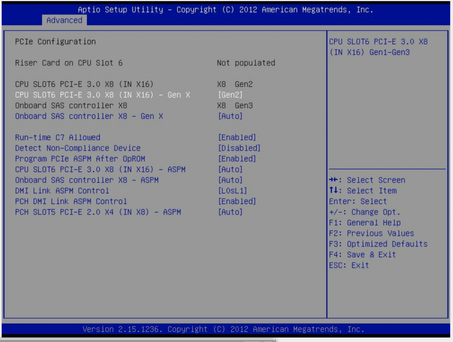

What motherboard and what LSI controller do you use?
I had this issue using an older LSI controller on a newer (at that time) Supermicro motherboard. After a lot of head scratching I realized the LSI controller was PCI 2.0 and the motherboard was trying to run it as PCI 3.0. Setting the BIOS to use PCI 2.0 for the LSI controller solved the problem.
On my Supermicro MB the setting is under Advanced->Chipset Configuration->System Agent Configuration->PCIe Configuration. Here is a screnshot showing how I had to force the PCIe 3.0 controller to use PCIe Gen2. The default of Auto was running the LSI adapter as a PCIe 3.0 for some reason and I was having exactly the same error on your screenshot. I hope it helps.
