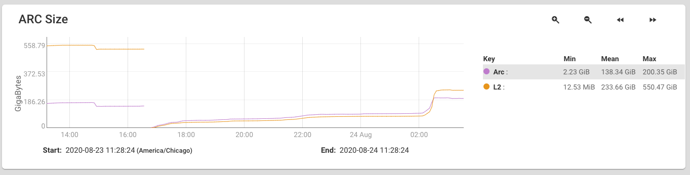

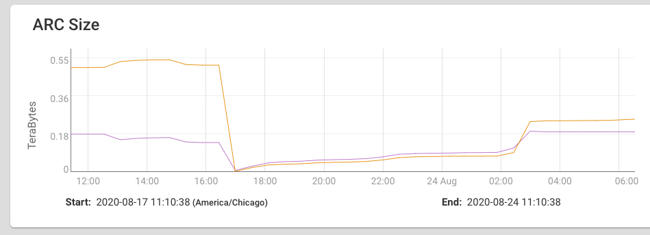

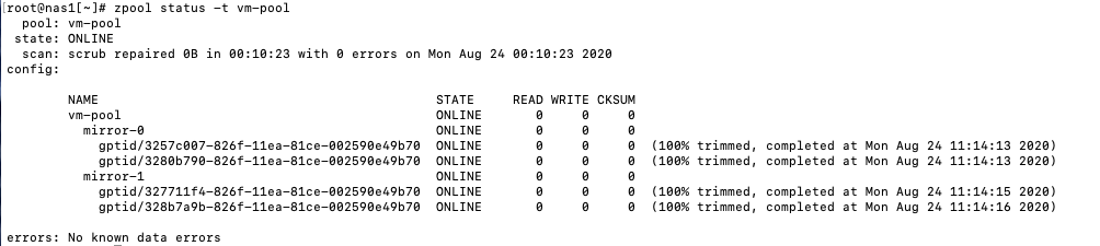

Persistent L2ARC is expected to get a button because in some cases, users will prefer it is not persistent. It may increase boot time with large L2ARCs.
Manual trims will be enabled via CLI or script in short term. If someone has a reason to use this, please experiment and provide some feedback.
Manual trim via CLI works fine. Persistent L2ARC doesn't appear to be functioning. L2ARC reset on reboot (see image).
Yorick
Nov 4, 2018
1,912
That's ARC not L2ARC. There's no L2ARC on your pool from what I can see, or am I missing something?
ARC, rather obviously, can't be persistent. It being in DRAM and all.
