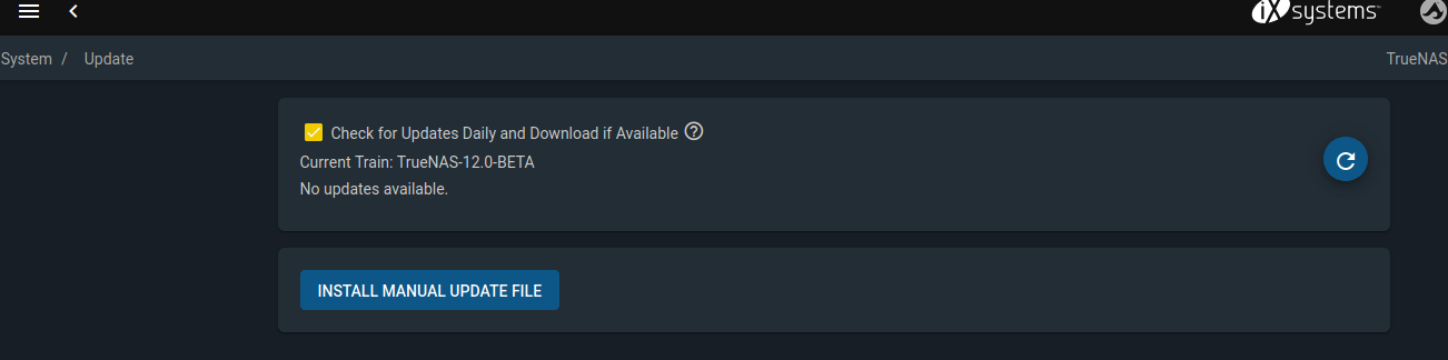

unfortunately even after the upgrade to BETA2 the update function in the GUI or changing trains is non existent.
see after screen shot from BETA2.
would this be considered a bug? should i log a bug report?

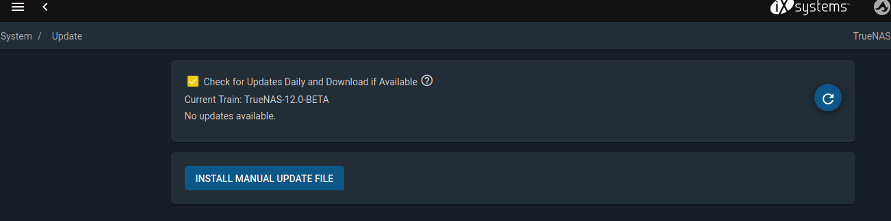

I just used the ISO method on boot via USB was a quick and painless exercise.

There are no updates past BETA2... so this would be expected behaviour.

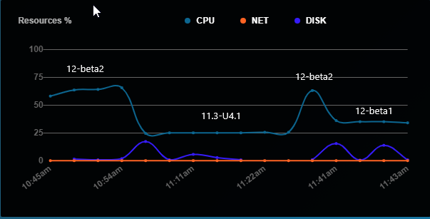

I had TrueNAS 12-beta1 set up on a test server and recently updated to 12-beta2. The first thing I noticed was sluggishness on the test server. I also noticed that TrueCommand was telling me that CPU use was consistently high. I switched back to 11.3-U4.1, back up to 12-beta2 and then down to 12-beta1. The results of these actions are reflected in the TrueCommand graph below.
What this reveals is that idle CPU use increases slightly in switching from 11.3-U4.1 to 12-beta1, but then there's a massive jump in CPU use going from 12-beta1 to 12-beta2. Note that I started with a fresh install of 11.3-U4.1. There are no jails running. It's a bare-bone system.
