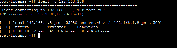

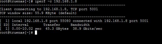

vasu
Apr 10, 2023
I am facing too slow speed over my network. I am new to truenas can you any one help me to speed up my network. I did a test with iperf. result screenshot attached
