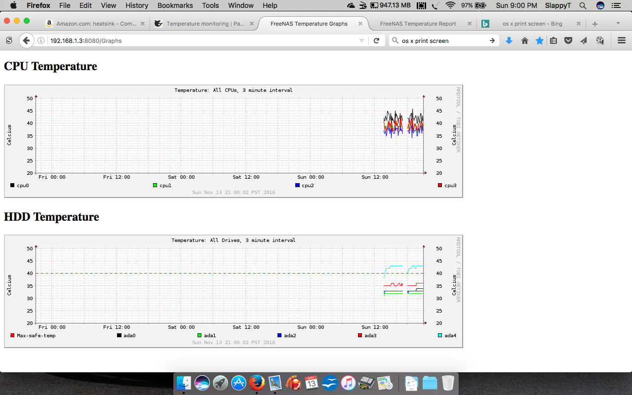

This is great !! Thanks. This works like a charm! I even made a html file and embedded the png files. Then created a webDav share to the html file so that way you don't have to access the share folder to view the graphs every time. Now if I could just get something like mbmon to work then I could monitor the system temp as my case is VERY unorthodox.

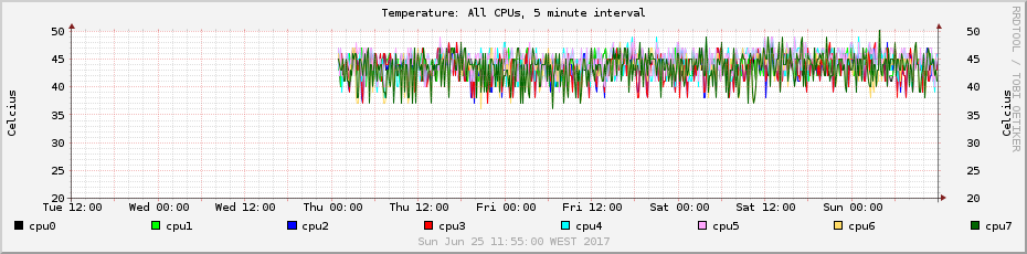

I mean, if it is possible to change the footer, in the attached chart, we can see that the dates shown go from Tue 12:00 until Sun 12:00, it shows the values obtained in 6 days and i was wondering if it would be possible to change the start for ex. Tue 00: 00 and the end for Mon 00:00. So the graph showed in detail the values obtained during 24 hours.
Thanks again ;)

Ahh, ok. What you ask possible I believe (https://oss.oetiker.ch/rrdtool/doc/rrdgraph_examples.en.html has some good info), but I haven't done research to figure out exactly how. Currently rrdtool graphs the data file with the default width and density, but I'm sure they can be adjusted. I'm not able to do this research at the moment due to time constraints, but if you do figure it out, post it here and I'll see about adding it to the script.

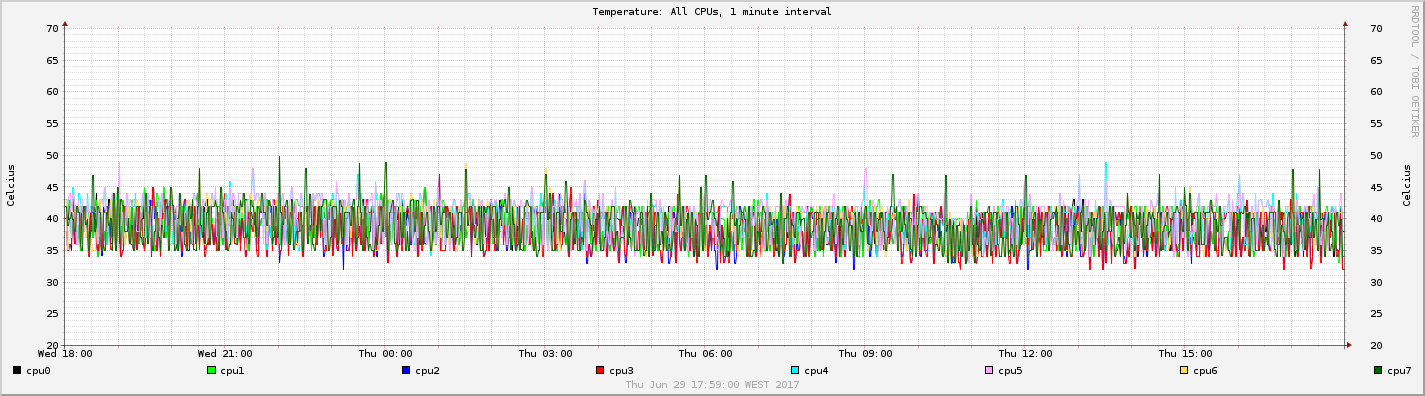

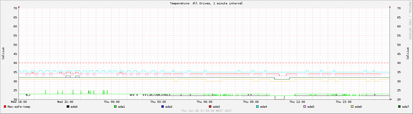

I @Seren i find a way to do it, i replace the line (file rrd-graph.sh):
--start end-"${timespan}" --end now \
with
--start end-86400 --end now \
Thanks
