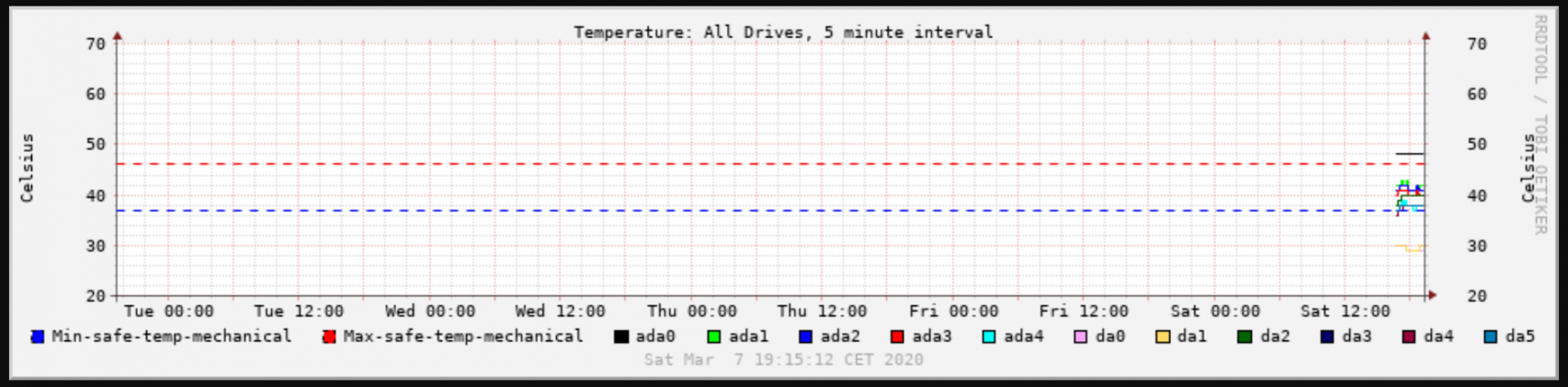

Start jail and open web browser:
http://jail-ip-address/temp/
So you can see directory listing of files in the temperature-monitoring folder:
Just click on one of png files to see temp stats, CPU or drives:
