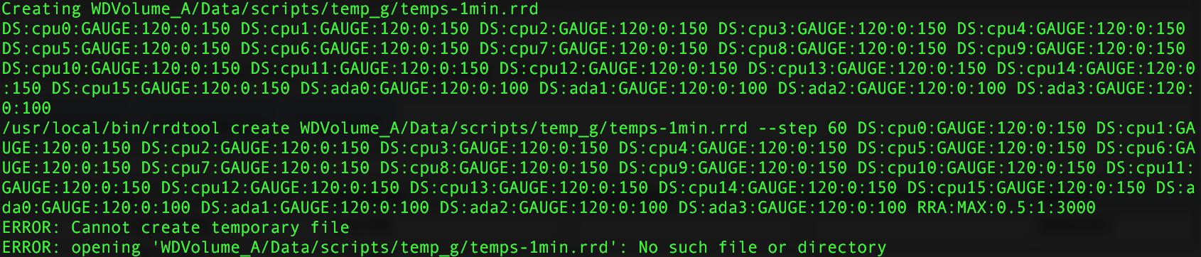

Jacopx
Feb 19, 2016
367
What is wrong?? I have already check the dataset permission! :(

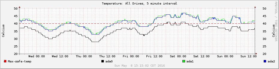

So, how much data is there supporting your line at 40C for "max safe temperature" (drives)?
Among many other things, these graphs point out differences in cooling in different spots in the cases, too :)
15,504
The 40C max has been discussed quite a bit around here; IIRC it comes from a study Google did of hard drive reliability, where it was noted that failure rates increased significantly when the drives were run above that temp.
Jul 13, 2013
286
The Google study finds some effects at 45C for newer drives, maybe at 40C for older drives. Backblaze, on the other hand, finds few correlations (weak ones for some Seagate drives); however they're mostly looking at lower temperatures, so that doesn't directly refute the Google findings.
I guess it's remaining complicated. No real surprise there.

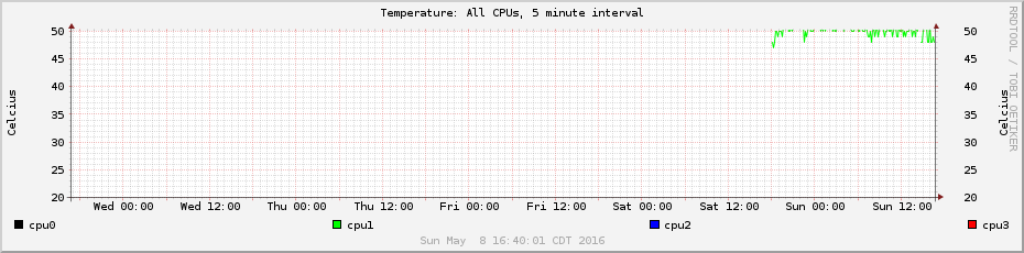

Jul 13, 2013
286
And maybe the temp scale for CPU temps should be changed. At least according to this page, temps well above 50 are quite ordinary, and the "idle" temps are often around 35C.
Which is good since one of mine is running consistently above 50C.
(by poking with the simple-temps script, I see that cpu1 drops below 50 occasionally, the other three cores do not)
15,504
Yes, I noticed the same thing. Look through the scripts for the command that makes the graph, and remove the --strict parameter from it.
