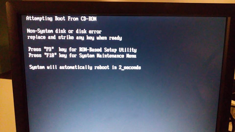

I installed 9.3 to an IDE disc via the CD-ROM. After the install I dropped to the shell and executed "zpool scrub freenas-boot" and "zpool upgrade freenas-boot". All went well, but still no Freenas 9.3 boot on my HP Proliant ML310 G4.
After boot, the system continues after the BIOS (this is a progression in comparison with the USB stick). But then I get the screen I attached.
Where-ever did you see that you should run that? If I remember right, upgrading the boot zpool is fatal to future booting, as grub doesn't support pools that are > v28. I think there was some attempt to prevent this from happening if you did a "zpool upgrade -a", but being that you specifically told it which pool to upgrade, you might have made your boot zpool un-bootable.
The scrub is fine, but the gui automatically kicks those off on every install and upgrade too I think.

I think I have bad new for the HP Proliant users: http://h20565.www2.hp.com/hpsc/doc/...248036&docId=emr_na-c02873092&docLocale=en_US
"The problem resides on the fact that all operating systems initialize the logical drive in MBR mode, which can only address up to 2Tb of partitioning.
GPT is a replacement of MBR, where GPT can address up to 9.4Zb.
But, initializing the boot logical drive as GPT (by other means) will not work, as ProLiant BIOS are not EFI/UEFI complaint, and this is a requirement to boot off GPT volumes.
