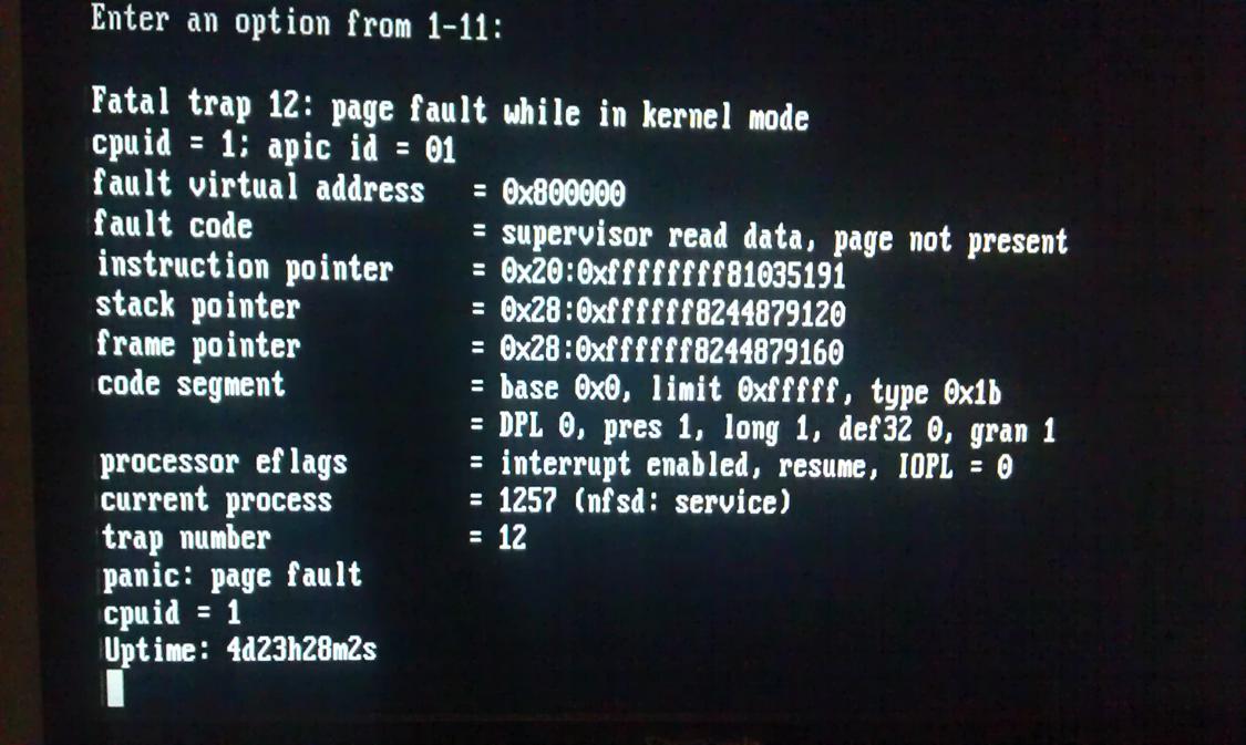

jensbylu
Aug 29, 2011
4
Ok, happend again. Second time since I upgraded to 8.0.1 RELEASE.
This time I took a "screenshot". Seems to be an issue with nfs deamon?
This time it occoured when xbmc on my kubuntu laptop where accessing än nfs share monted on the laptop.
G
gcooper
Guest
This is a completely different problem (and it'd probably be a good idea to open up a separate thread/ticket for it -- please include all your hardware details, version number, how you're connecting to and from your kubuntu box, etc).
