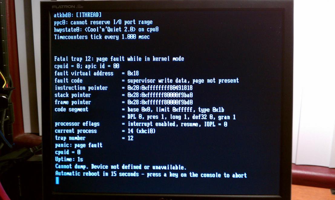

Hello.
I seem to be having a major problem after upgrading my FreeNAS box to the new 8.0.1 release. I did the CD upgrade with no reported install errors. As soon as the system rebooted, it will start booting up normally past the FreeNAS splash screen, past a few of the start-up procedures, and will then halt at the error message attached below in the picture. I tried the same thing by doing a fresh install instead of an upgrade, and same issue, it hits the error message and ends up in a reboot cycle. I don't have the full specs right now, but the box is booting off a 16GB Kingston SATA SSD, is based on a dual core consumer AMD processor, and has 8GB of DDR3 RAM. The main array is based off 4x 2TB Hitachi SATA drives that were running RAIDZ. I have searched the forum and the bug database, but have yet to find an answer. I also did a Google search on the Fatal trap 12 message but no luck either. Help would be greatly appreciated.

I woke up to find the same screen as @thedeepfriedboot posted.

I actually had the same error crash my router as well yesterday. My router runs pfSense which is also FreeBSD based. I upgraded it a week ago to the new release and I got the exact same error screen yesterday. The router was running for a week, and then I came home yesterday to find the router locked up. Perhaps the new version of FreeBSD is to blame for these issues?

Disabling xhci might fix the problem. When booting up the machine do:
1. Boot to loader prompt.
2. unload xchi
3. boot
This driver should really be removed from the default load list.

What does that do? Since my system is crashing right as it starts up, and since I dont have email set up, I dont think its email causing the issue for me.

That's a problem with the USB 3.0 device driver. It doesn't like certain machines, sadly. Is the machine in question one with an AMD chipset by chance? Can you provide the board mfr & model number?
If you can disable USB 3.0 in the BIOS, try that, and make sure the boot volume, if on a USB stick, is in a USB 2.0 port. Otherwise you'll need a custom kernel to remove xhci. This is addressed in future versions by making the xhci driver load as a module so it can be disabled if needed. (That might have made it in the last RC, I've lost track.)
What Doug said... and I typoed in my instructions above (it's 'unload xhci', not 'unload xchi').

When reporting panics, it is important to quote the _entire_ panic message, including the addresses. Screenshots are great. There are 3,500 sources of panics (calls to panic()) in FreeNAS. Trap 12 is an invalid memory reference and isn't in itself diagnostic; there are 2^64 possible causes of an invalid memory reference. Along with the fault address, instruction pointer, and source process from the message, we can usually identify what the offending subsystem is. But without it, there's no possible way to debug it.
Dam, that must be it. The board has USB 3.0, is AMD, and is the GIGABYTE GA-880GMA-USB3. Would that board be the problem? Also, if so, would you recommend turning off USB 3.0 in the BIOS, or disabling that xhci file? Oh, also, im not booting off a USB drive, I am booting off a 14GB SSD connected to SATA. Newegg had it on sale.
