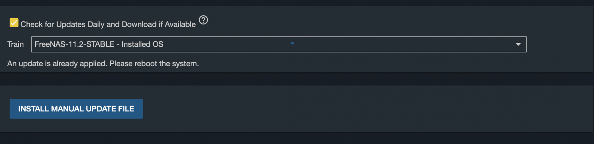

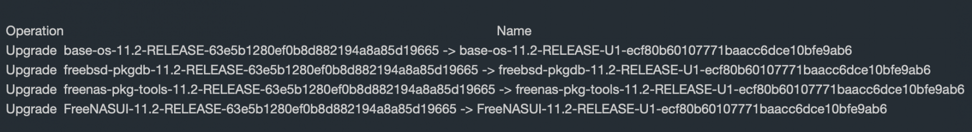

Ok about 50 minutes in... it appears that the ui froze at base-os install percent of 62.5%. I hit refresh, logged in, and clicked on check for updates. and it appears that the update was successful?
There was not a reboot done by the system automatically... So not sure what's up with that.

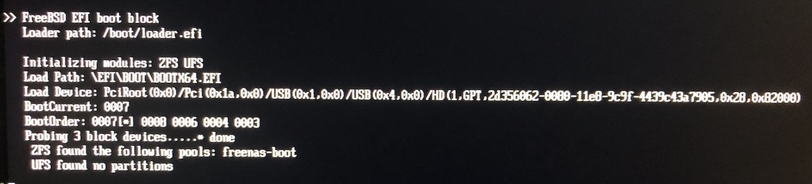

Wait, FreeNAS is no longer compatible with ThinkServers (e.g. TS140) and the beloved intel NICs? Am I in the twilight zone right now? And yes - I'm dealing with the same issue on a TS140 w/ Intel NIC.
Did not have this issue with versions 8, 9, or 11.1 - this issue is NEW with 11.2 u2.1.
When I re-install with 11.1 this issue goes away. Any ideas if this has been hammered down as an actual issue with the 11.2 bootloader and/or USB stick image?
