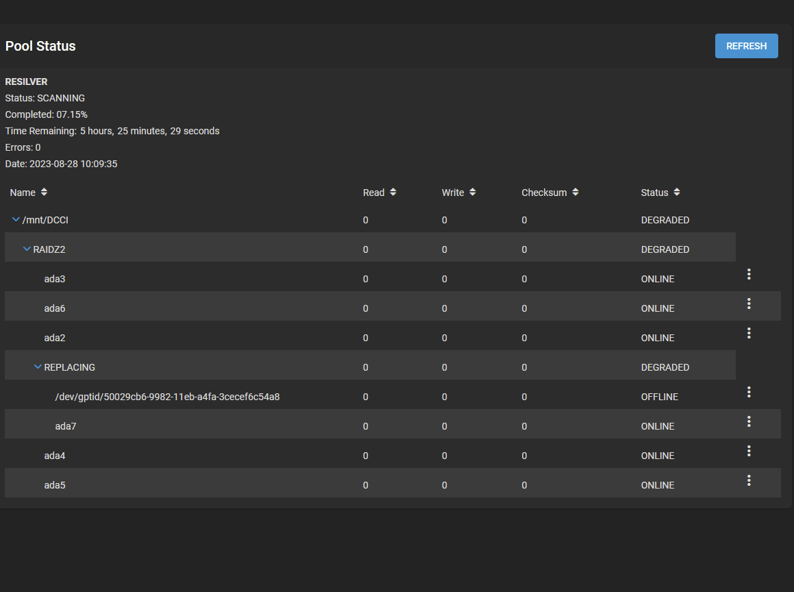

I started replacing drives today. On the backup server, I didn't have a spare SATA port, so I offlined one 8TB WD drive, installed the new (tested) Seagate 16 TB drive, then clicked replace and selected that new drive. That seemed like a fairly smooth operation. (except my pool is degraded during the resilver)
Shows estimated 5+ hours for resilver.

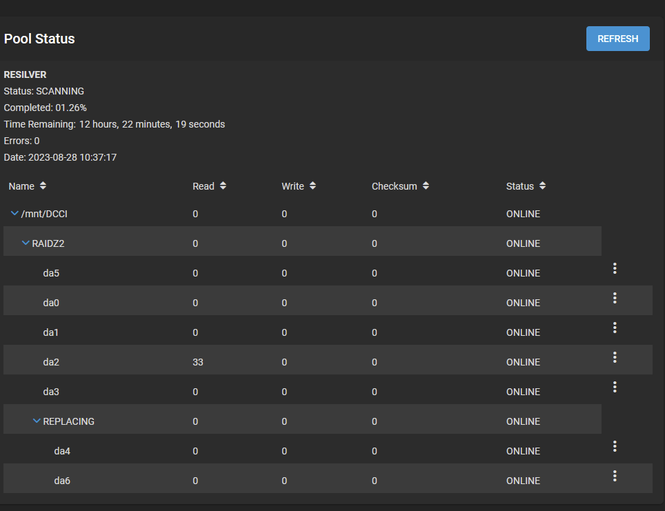

I have extra SATA slots in my older production system, (da4) so I installed the 8TB WD drive in an open slot, found the drive that was kicking all the S.M.A.R.T errors, and used the replace in place function.
At first it told me that it was going to take 19 days to replace it, but this is what it shows now:
Wondering why it is taking longer to replace in place than a resilver from scratch?
Why does one system name the drives ada1... and the other names them only da1...
The system that is naming da only is one that I built 8 years ago that has been upgraded from FreeNAS. It calls the DOM boot drive ada0 and the pool drives da1... etc... The TrueNAS from the start calls all drives ada0... ada0 and ada1 and the pool drives are ada2 - ada7
9,703
SAS (SCSI) vs SATA.
Ignore the estimates, it probably isn't.
The correct way to read that is "as soon as I took a disk offline in my pool, it was degraded".
Driver difference. da is driving the older drives that uses parallel ATA interface whereas ada (advanced da) is for newer drives that uses AHCI controller interface.
