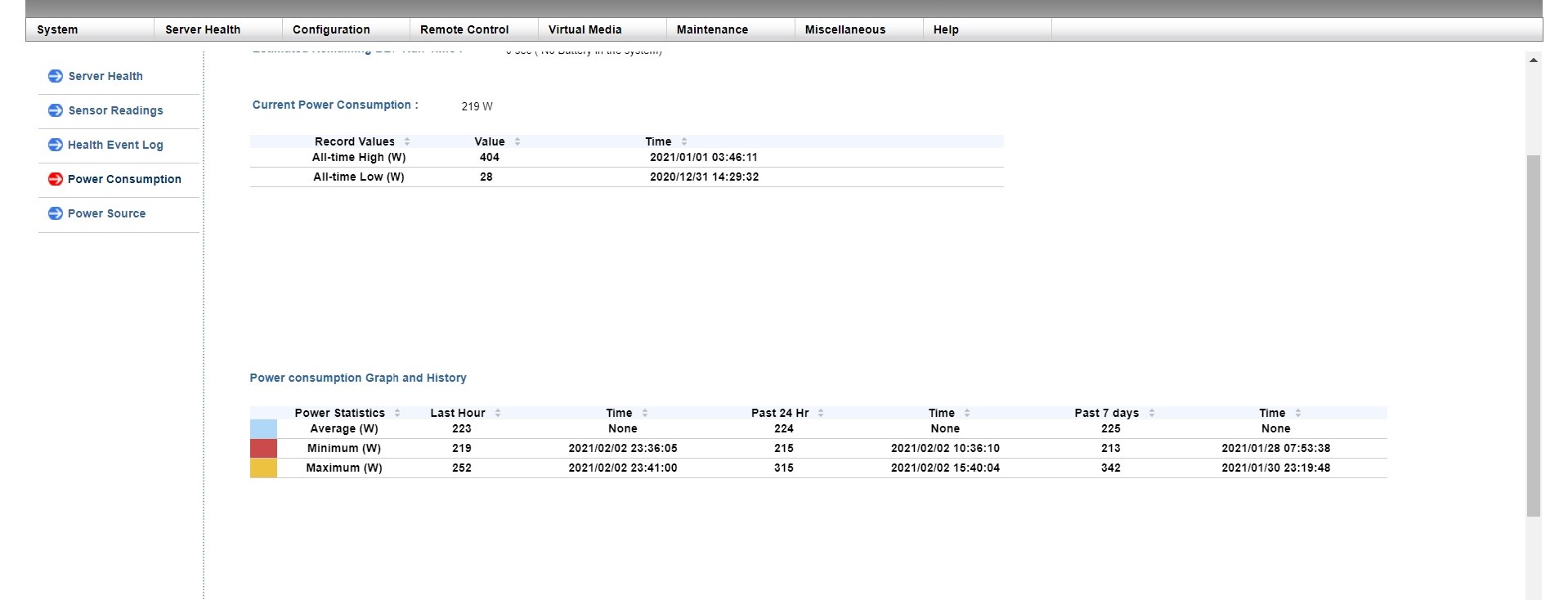

Jailer, what sort of power consumption are you getting from you build in signature? im building something similar
No clue, I've never checked it.
G8One2
Jan 2, 2017
248
I think the amount of physical drives, have more to do with power consumption, than the rest of the hardware. I could be wrong about that though, but I can tell you my system idles around 200 watts with 18 hard disks ( 3 vdev's )
