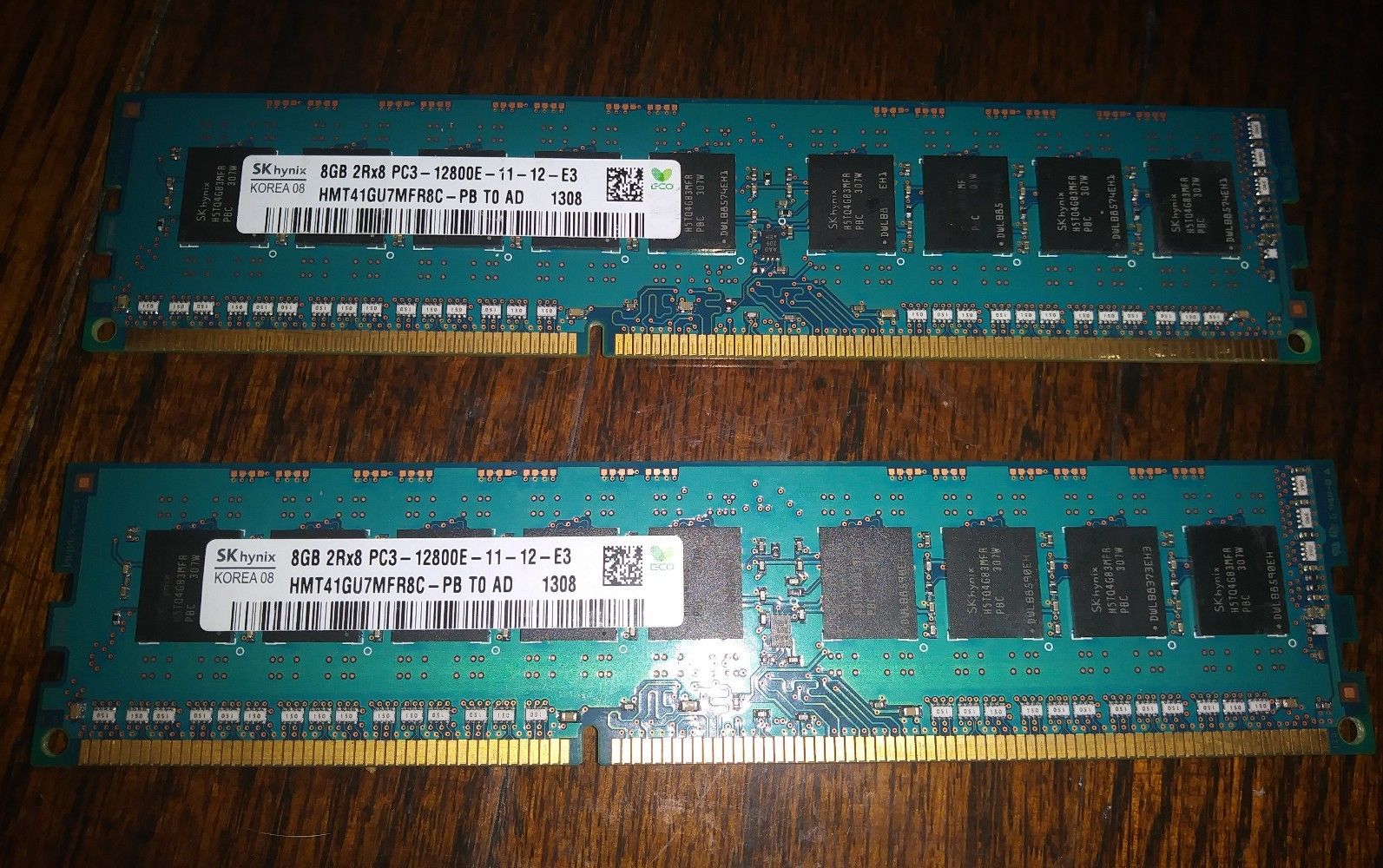

I have a question, I'm using the vendor suggested memory for my supermicro board.
I bought two sticks of Hynix HMT41GU7MFR8C 8GB DDR3 memory.
I wanted to get two more sticks and I noticed my ram has "PB TO AD" on it after the part number.

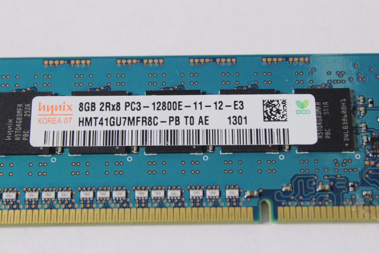

I am looking at some that are identical except it has "PB TO AE" after the part number.
Is that something I need to be concerned with? Or will it it work? I know ram is finicky sometimes and wanted to make sure.

I would try to pair the like sticks, but you should be fine. It looks like one set was made in 2008 and the other set was made in 2007 and it probably just indicates the different production run. Where it says, "2Rx8 PC3 - 12800E," is the important part because that tells the rank, speed and that it is error correcting. It could actually be from another vendor and still work. I have a system with two Hynix and two Kingston and it works perfectly. That whole second line of text is just the vendor part number.
