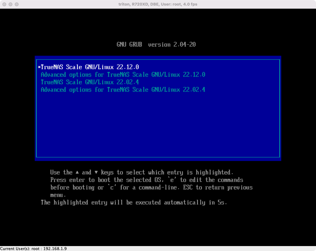

I upgraded to Bluefin 22.12.0 and I experience the same behaviour on my Dell R720xd, booting from a Samsung SSD attached to internal USB port. I'm stuck at GRUB for 20min or I can proceed if I press Enter at screen. @Ashkaan do you have a Jira ticket created? If you don't, I will create one with attached debug file and link it to Upgrade Discussion thread.

The 30 seconds default timeout is ignored:
# grep 'set timeout' /etc/grub.d/00_header
  set timeout=${GRUB_RECORDFAIL_TIMEOUT:-30}

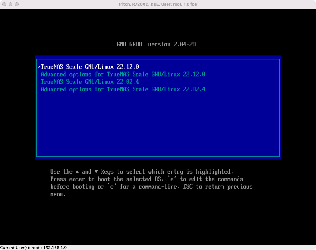

When you boot, do you see the countdown? In my screenshot it shows at 5 seconds, down from 30 seconds, then the booting process continues. If you change the default selection, the countdown is cancelled:
You can always press Enter during GRUB screen to accept the selected entry, until a fix is provided. I'm honestly glad this issue is fixed for me, all I did was performing a shutdown. I'm forced to do shutdowns, because the NetApp DS4246 attached to my R720xd server.

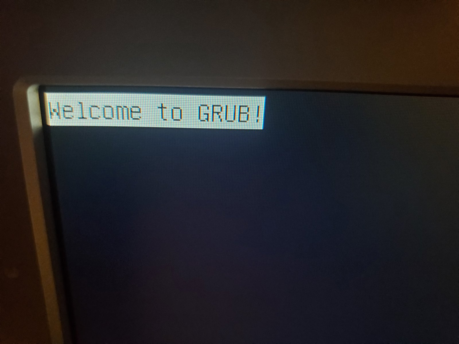

i wish i got your screen, i get a black screen and this. nothing happens after
I get your screen, but after 30m it will finally go. Have you tried waiting?
