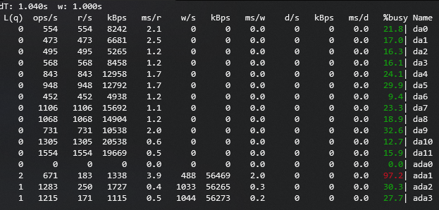

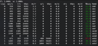

Background: I am in the process of performing some upgrades and redoing my system. Currently, I have two ESXi servers in a homelab connecting to my TrueNAS system. The systems are to help me learn and mess around with as I work in IT. I have also started using them for a few personal items like plex media server and a game server. I have added a few SSDs I had lying around to create an SSD pool for running virtual machines and then utilize my main storage pool as just file level storage over SMB for my plex server.
After adding the three SSDs to their own RAIDZ1 Pool, I created an iSCSI LUN and attached them to my ESXi servers. I vMotioned a single VM to the pool for just testing purposes and I was getting pretty slow performance. I used gstat -dp to monitor the individual disk usage and noticed that a single SSD (ada1) was reporting busy while the others were barely doing anything. This was also the case when performing an iozone test on the pool. This SSD in question is a Samsung 850 pro. I would expect an 850 pro to perform better than this. vMotion speeds to the SSD pool was about 80MB/sec or less. These are all older drives, so I am wondering if this one is starting to degrade and is on the failure path.
I vMotioned the VM back to my normal spinning storage iSCSI pool and read speeds were great. 400MB/sec read from SSD and 400MB/sec write to spinning pool. The bottleneck in that instance was the 10gb network. I then recreated the pool in a mirror without ada1 using just the other two in a mirror. I performed the vMotion again and both drives were busy and being fully utilized. This new vMotion was about 200-250MB/sec write to the SSD pool.
I am also guessing performance is going to suffer because the 3 SSDs are all different models.

1. Is there anything else that can be wrong with the 3 drive SSD pool with a single busy drive? Or is it a combo of probably bad drive and using multiple different models?
2. Any recommendations of SSDs to use in a 3 drive RAIDz1 pool? I would prefer to stick with standard consumer drives as I don't have a whole lot of money for this upgrade. Or are standard consumer drives a bad idea no matter what? I don't have a massive workload. I have:

The most obvious wrong thing is that iSCSI would do better on mirrors than on a raidz1. Can you add a fourth SSD?

Alright, I will look into running Mirrors. Wouldn't the 10gb link be the bottleneck before I even reach iops limits on the SSDs for the amount of VMs I am running? Most are not actually doing anything at the same time. I could probably get away with 4 SSDs if I had to buy 4 more, but I would like to keep the budget for this upgrade under $250.
In regards to the current setup I tested with
1. With ADA1 always being busy, could that be indicative of a bad drive? Or something else going on? Is there a way to test to see if the drive is bad? SMART doesn't report any errors, but I would expect an 850 Pro to perform better than the other drives.
2. Any recommendations for SSDs if I should use all the same model? Or just any SSD from a reputable brand?

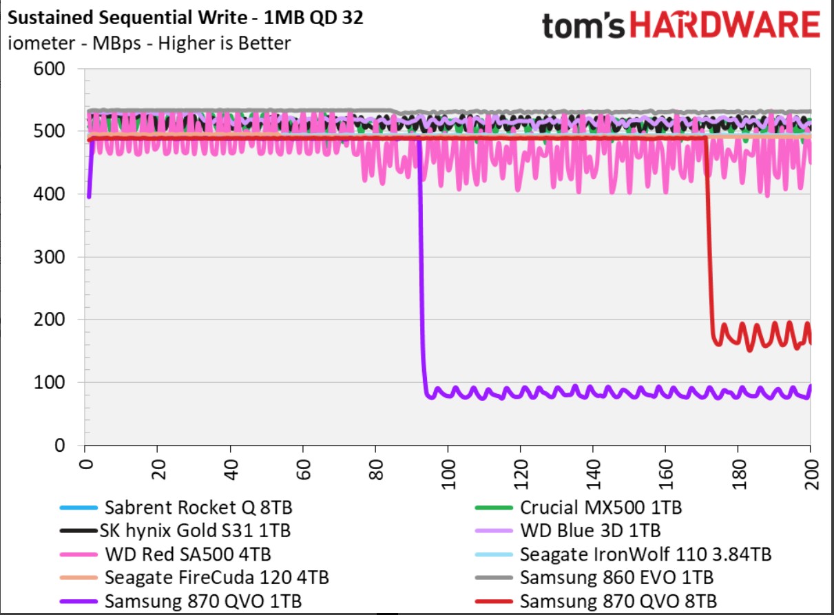

I am hesitant about refurbed drives. I was looking around and I also saw 1TB Crucial MX500 that look to be similar in price and performance to the WD Blues. This would allow me to do 2 vdevs of 2 mirrors to gain a little bit of performance. By chance have you or anyone else had bad experience with these?
I believe the MX500's have a known bug with SMART reporting that causes them to always report one pending uncorrectable sector, and then resolve it shortly afterwards. There's no fix for it, just a parameter to the SMART test that says "ignore that field" - but it ignores it entirely, so if it ever reports a genuine uncorrectable sector (or more than one) you wouldn't ever know.
Is there anything particular to look out for when trying to find SSDs to put in a pool like this?
Generally speaking you want to look for "sustained write performance" which is sometimes tested for by review sites. Consumer grade drives using TLC or QLC NAND can often ingest a burst of writes at "full speed" by using some of their NAND in a pseudo-SLC mode, which then they later "fold" into the TLC or QLC blocks. If you exhaust that write buffer, or if the drive firmware doesn't consider itself to have enough "free time" to do housekeeping with a slow-but-steady stream of writes coming in, then you eventually slam painfully into the threshold. As an example of a bad drive, the Samsung QVO drives can handle 500MB/s until they run out of buffer space, and then get throttled down to as low as 80MB/s (depending on the drive capacity) - slower sequential writes than a spinning disk.
Tom's Hardware has a nice graph from their 870 QVO review that demonstrates this - and also shows the WD Blue, WD Red, and a few other SATA SSDs there (notably not suffering the same effects)

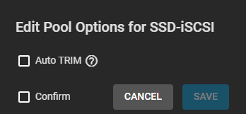

clifford64
Aug 18, 2019
87
OK. Should make the TRIM behind LSI HBA a non-issue then, but if the drives came straight from a consumer workload and never got a chance to be hit with proper secure-erase/TRIM (as I think pool autotrim is disabled by default in 12.x and later) the internal firmware could still be confused as to whether or not it needs to care about what exists on the NAND now.
Currently Auto TRIM is off. Should this option be turned on?
HoneyBadger
actually does care
Administrator
Feb 6, 2014
5,112
In your case specifically, I wouldn't.
TRIM was disabled by default in TrueNAS 12.0 due to a change in OpenZFS TRIM behaviour where async or "queued" TRIM is now used - and if I recall correctly, there was a rather large amount of back-and-forth between Samsung and the Linux kernel developers as to whose fault it was that certain Samsung models (it appears to be the 860 and beyond?) would falsely represent themselves as having queued TRIM support, when in reality they would TRIM the wrong LBAs.
I would instead connect the drives to a Windows PC, use the Samsung Magician software to do a full TRIM/secure erase, and then rebuild the pool.
