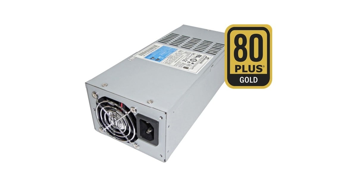

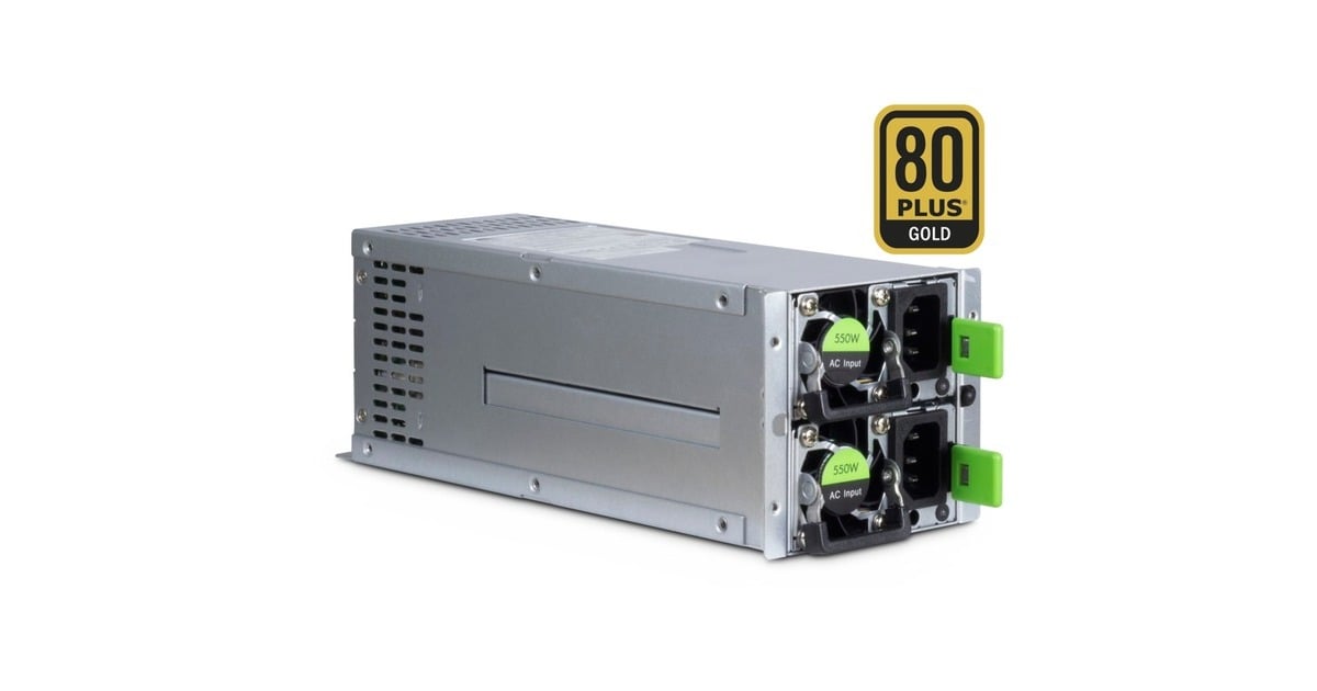

I was looking for these options:
- Seasonic SS-500-L2U-500W-2U:
- Inter-Tech Aspower-R2A-DV0550-N
I have the limitation of 2u size, i think that the Seasonic its enough for my NAS and its not very expensive
And the other one, the Inter-tech... well, is just a expensive whim, but maybe in the future i want to upgrade to other motherboard more powerfull and maybe create VMs directly on TrueNas Scale and not in proxmox...
And i dont care about spend money in the power supply, because the life of a power supply its too long BUT i dont want to spent more than the 300€ haha that number is too high for me
Any recomendation?
