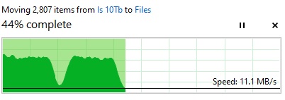

Sarunce
May 7, 2021
13
This is how it looks.
that dip is drop to 11.4MB/s and around it is 100+MB/s
As you can see its started at proper speed then droped, I re-applyed network settings and it went back up

Constantin
Vampire Pig
May 19, 2017
1,829
Are these files all the same size or are we looking at a mix? Small files can cause significant dips in throughput.
Maybe but my guess is something with the "cach" drive that probably doesn't need to be there or network complexity that doesn't need to be there
Sarunce
May 7, 2021
13
It is doing the same thing on what ever I try to move in to it most of the files was big movie files
