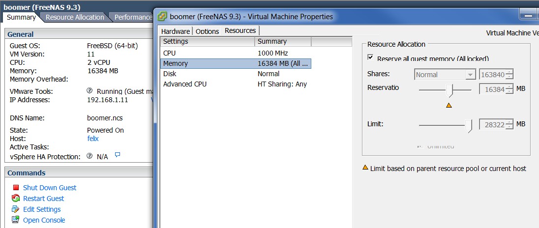

Make sure you reserve/lock all of the memory you provision for it (Settings->Resources->Memory).
Try reducing the number of vCPU's to 2 from the 12 you're using now.

Is it possible you're running at SAS speeds (3Gbps) and not SAS2 (6Gbps)? Is the HP SAS expander you're using a SAS2-compatible device? One way to check would be to look at this log:
/var/log/messages
It will list the disks and their transfer rate, like this:
Jun  1 22:58:27 boomer da2: <ATA HGST HUS724020AL A580> Fixed Direct Access SPC-4 SCSI device
Jun  1 22:58:27 boomer da2: Serial Number  PK2134P5G3PNVX
Jun  1 22:58:27 boomer da2: 600.000MB/s transfers
Jun  1 22:58:27 boomer da2: Command Queueing enabled
Jun  1 22:58:27 boomer da2: 1907729MB (3907029168 512 byte sectors)
