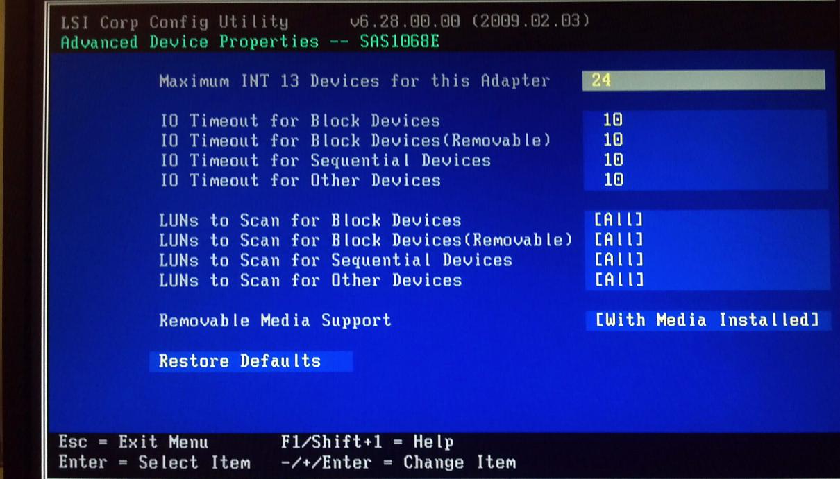

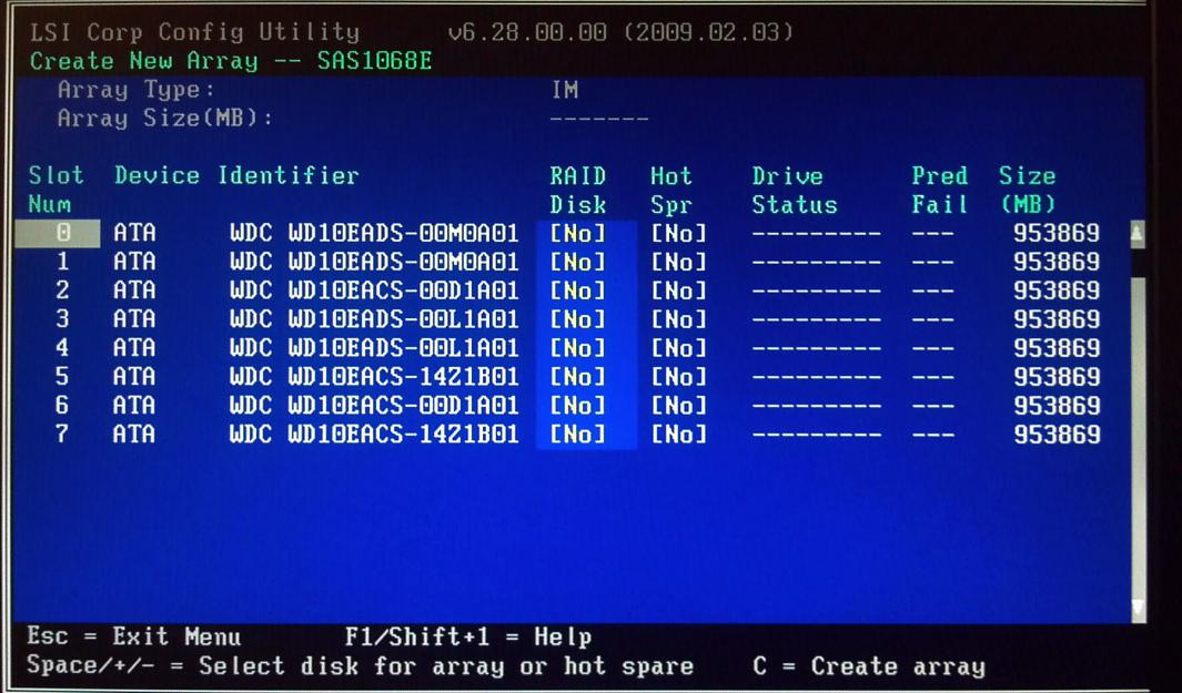

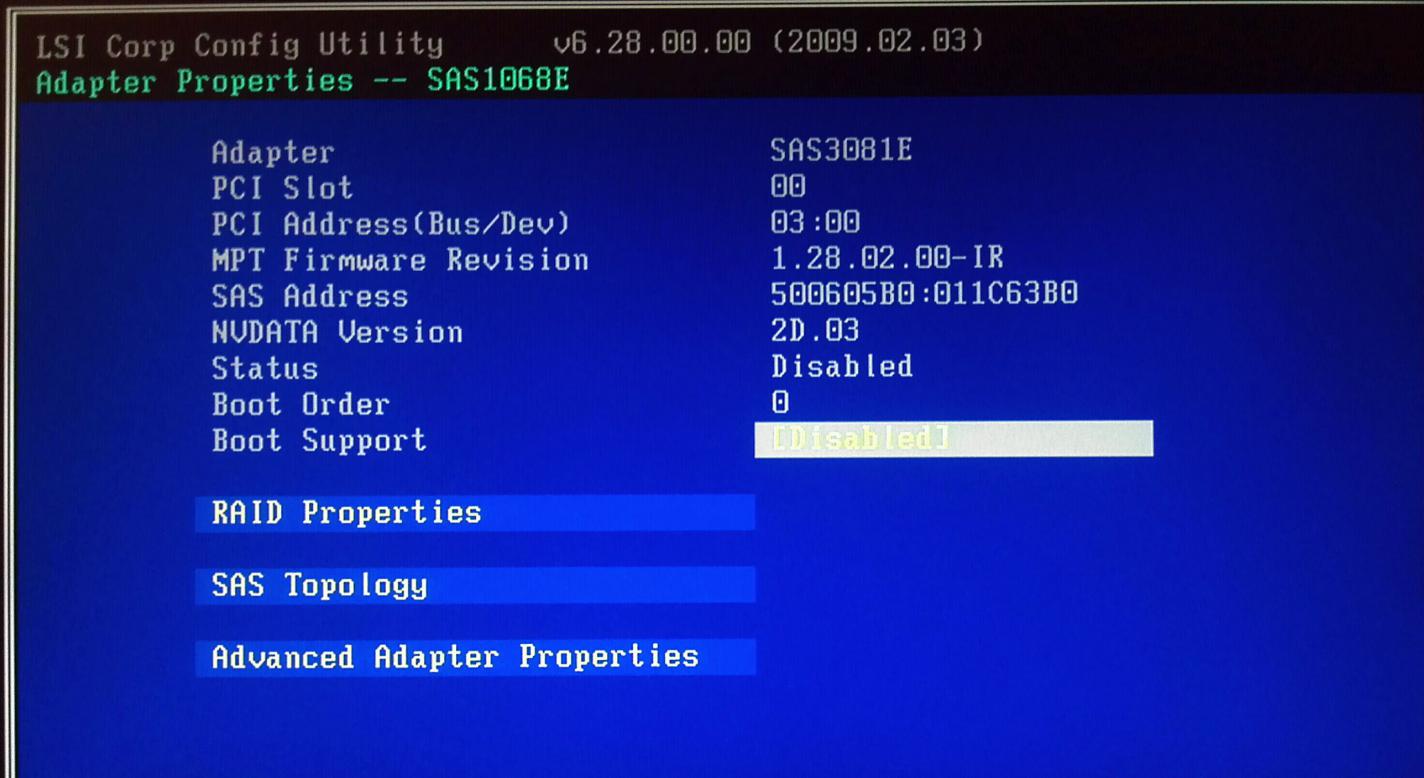

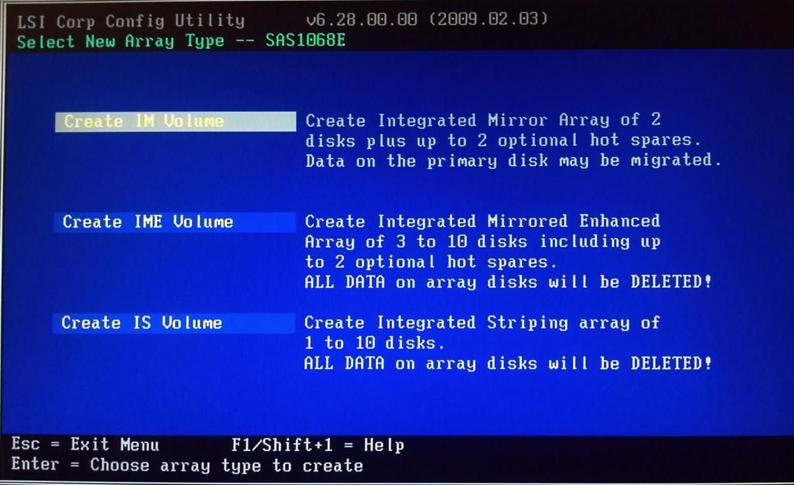

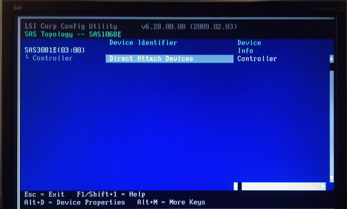

finally got around to rebooting. i took screen shoots of all the pages of my controller. 2011-07-18.21.00.05.jpg 2011-07-18.21.00.45.jpg 2011-07-18.21.01.10.jpg 2011-07-18.21.03.40.jpg 2011-07-18.21.04.17.jpg
