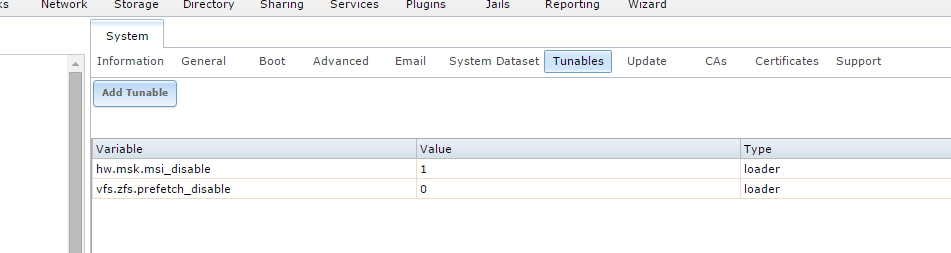

depasseg
FreeNAS Replicant
Sep 16, 2014
2,874
So what exactly happens? Do you have console access when this problem occurs?
I had something similar on my freenas2 (marvel nics). The NIC would hang after a hefty network transfer. Using the console, I could see that the machine was ok, it was just the network that hung. If I stopped and started the interface, all was good.. After some googling, I applied a couple tunables and the problem hasn't come back. There might be something similar for the Intel PCIX NIC.
