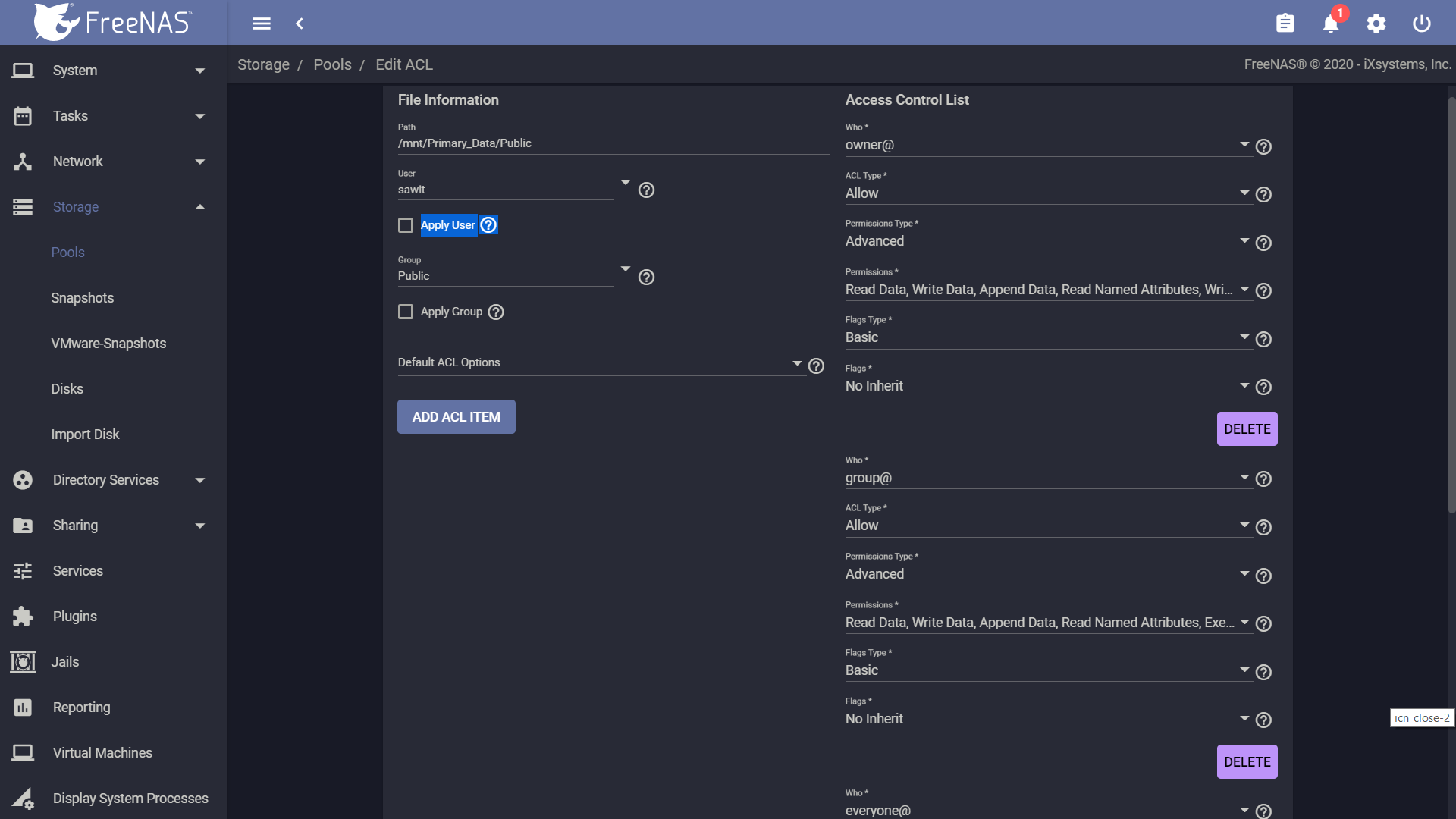

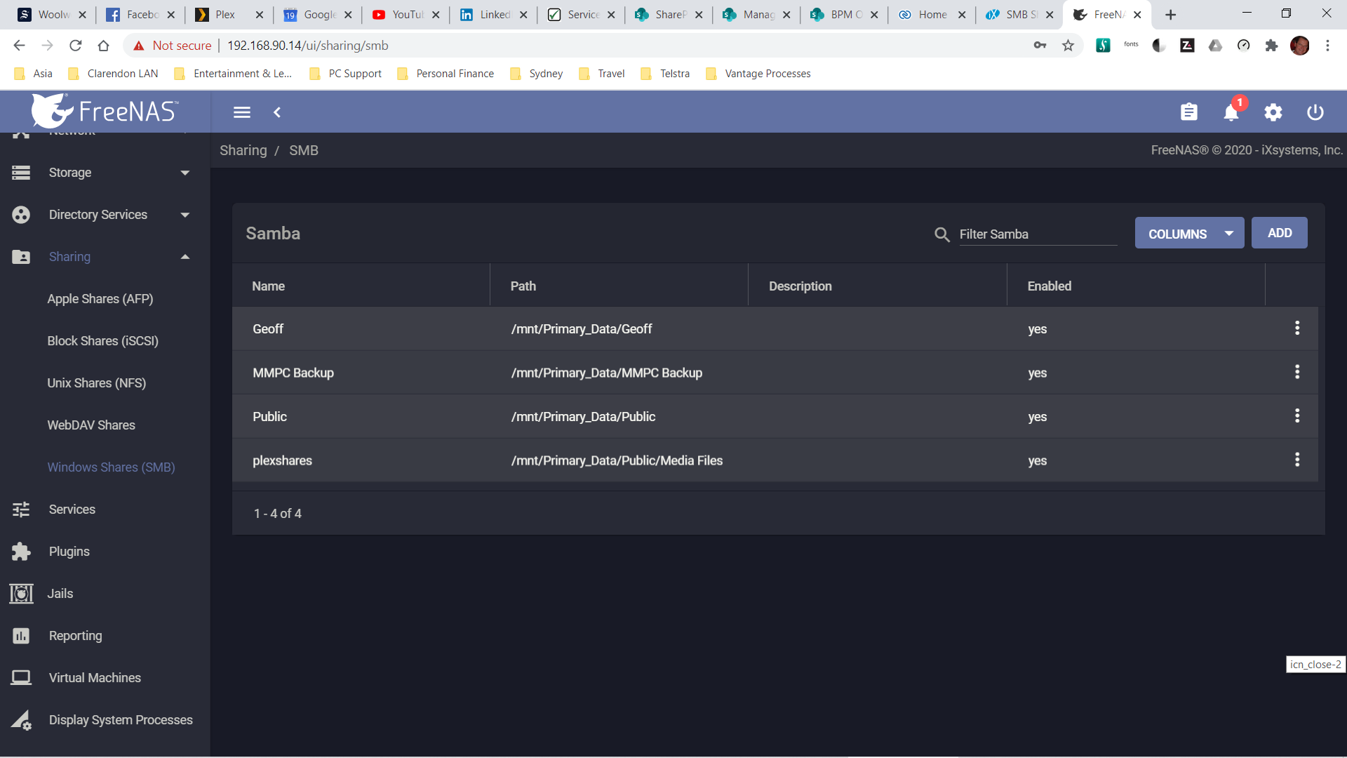

OK so I am having the same EXACT problem. While Geoff seems to be novice at using command line and putty he seems capable. I am a Linux \ Windows guru and I have to say that FREENAS is the most complicate, difficult appliance ever. I can get iSCSI to work, so obviously the other things like IP and storage is working. I have reinstalled freenas 3 times now and this is extremely frustrating. I have another device openfiler which works PERFECT, now I get freenas because interface is better and performance is better, but I can go back to openfiler not a problem.
I cannot get shares to work. I am a Windows admin going back 20 years, so this is NOT new. I do hyper-v Administration this should be VERY simple but it's not.
I have done ALL the steps looked at the manual back and fourth there ARE no options missing. It is simply NOT working. smb.log shows nothing except ready to accept connections. So why is this NOT working have no clue, but as I have Netapp, Jetstore, Convergent, VMware, vSAN, and an entire Datacenter under my belt this is the *ONLY* appliance that is giving me trouble, it's not even for work it was something I was going JUST to test.. but this seems fruitless. Can't understand why people insist on making layer upon layer of non-sense just to get a share up.. ridiculous. I can stand up ANY windows server, get shares and permissions in 20 minutes start to finish no problem. All other SAN as I mentioned working great they ALL have shares setup first time some use SAMBA, so I am also familiar with that, but this is incredibly restrictive to use FREENAS.
It's not a total loss, as iSCSI works, networking, I have Directory Services it's working great. I have installed 3 times, rebooted this appliance 4 times still nothing. As Geoff states what are we overlooking? I think it's a simply FLAW in the software. I came here not looking for support but merely to reinforce Geoff frustration, it's utterly insane that things need to be this complicated to setup. INSANE!

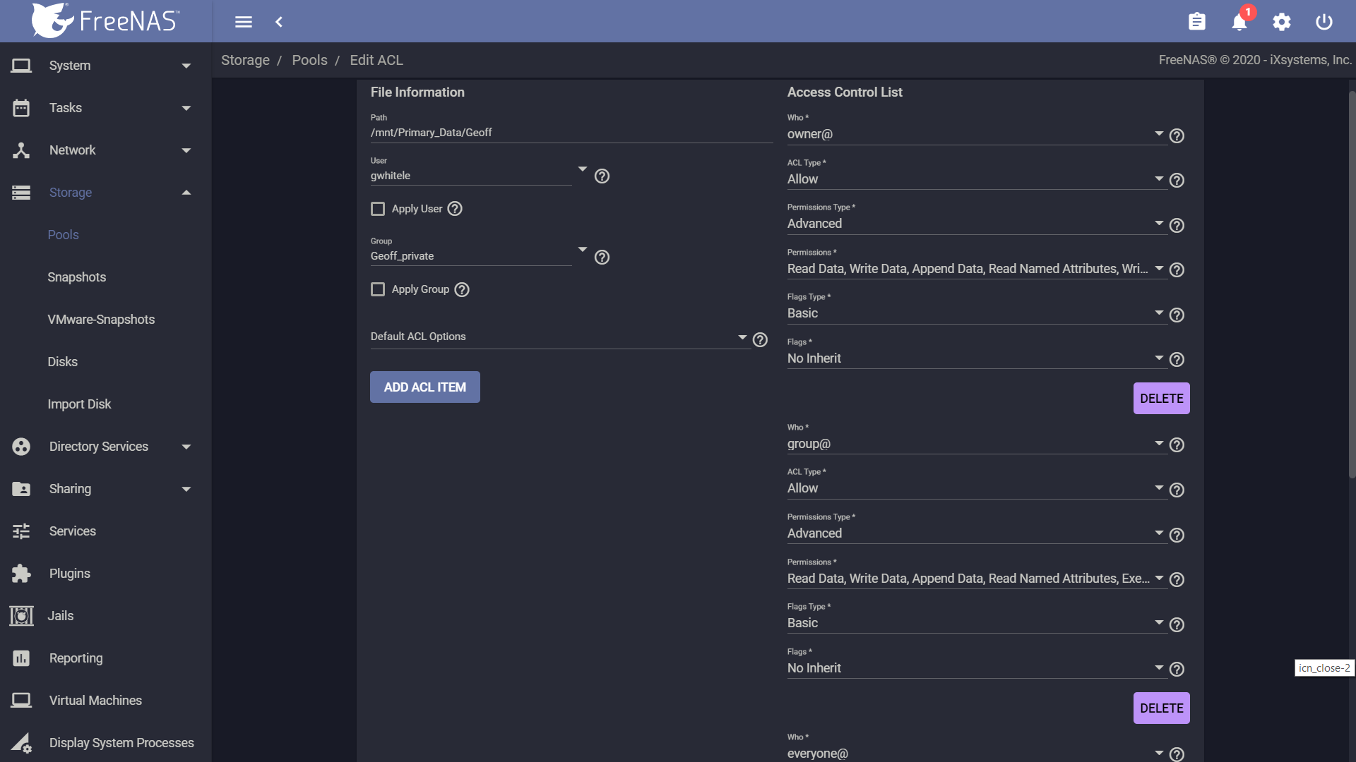

OK, you have a permissions issue with your share, because Samba can't traverse the directory structure to get to your dataset. Please display how you have the share defined, and the ACL for the share.

@atl_vm, please start a new thread. In all likelihood, you've encountered a misunderstanding with the permissions/ACL structure.

It doesn't matter how ACL works, it should still respond to the \\0.0.0.0 IP and at least give a blank screen or prompt for credentials. Not doing that. That's how I know SMB is NOT working, has nothing to do with credentials, permissions or share. If service is running windows should realize it's able to 'talk' to SMB server and get some valid response, even if it's blank. That's what I am talking about. It's NOT working.

OK, so you've got a guest share at \\<FreeNAS IP>\shared. What's the output of
ls -ld /mnt/PERF
ls -ld /mnt/PERF/shared
and the ACLs you've set on shared?

I need the output of:
ls -ld /mnt/Primary_Data
ls -ld /mnt/Primary_Data/Geoff
ls -ld /mnt/Primary_Data/Public
geoffwhere
Apr 23, 2020
105
root@freenas[~]# ls -ld /mnt/Primary_Data
drwxr-xr-x 7 root wheel 8 May 4 14:45 /mnt/Primary_Data
root@freenas[~]# ls -ld /mnt/Primary_Data/Geoff
drwxrwxrwx 13 gwhitele Geoff_private 13 May 3 13:25 /mnt/Primary_Data/Geoff
root@freenas[~]# ls -ld /mnt/Primary_Data/Public
drwxrwxrwx 9 sawit Public 9 May 8 17:46 /mnt/Primary_Data/Public
Hope this guides you to the problem, thanks again.
geoffwhere
Apr 23, 2020
105
Hi there, I'm wondering whether I provided the information you needed from your AUG24 post (see above post). Please let me know if I've correctly answered your request.
Samuel Tai
Apr 24, 2020
5,399
What user account are you using to access these shares? According to the ls -ld output, the Geoff share is restricted to the gwhitele user or the Geoff_private group. The Public share is restricted to the sawit user or the Public group. Is your account a member of both groups?
