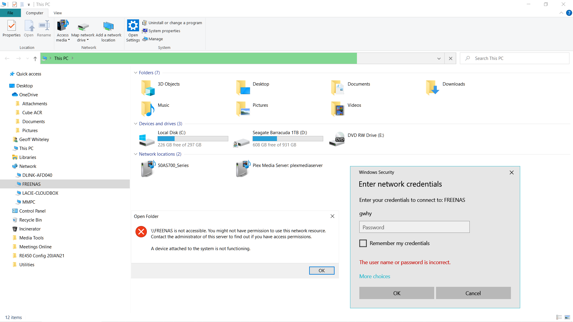

Bizarre. Still unable to access. I'm starting to lean towards some bad setting in Windows, but a few iterations ago without making any changes to Windows since, I was at least able to access both FREENAS\Geofff and \Public (I think that was before we changed the dataset permissions via Shell - might have that timing sequence wrong).
Here's the screenshot of this last iteration. I tried this twice, the second time after going back to the User and re-entering the password, just to be sure I had it right when trying to sign in from Windows Explorer.

Well, I thought just using one isolated test share would prove to work as there should be no confusion over credentials , no complication of Windows trying to establish a connection for a guest account, etc. Incidentally, guest access to shares is being phased out in Windows and is not recommended.
Have you got a solid connection between your PC and FreeNAS machine, i.e. wired and not wireless? Have you given your FreeNAS machine a static IP address rather than relying on DHCP, or at least reserved a lease for your FreeNAS machine? Pity you're not linux literate as you could test the SMB connection from linux and then be sure it's a Windows problem.
The screenshot shows your Windows machine sees the FreeNAS server and this ought to mean you've got file and printer sharing on for your private network. It's worth checking your Windows network settings and ensure you can "ping" your FreeNAS box from Windows.
Did you try just selecting the Network icon in the navigation pane and then typing "\\FREENAS\testset" into file explorer? Have tried substituting FREENAS for it's IP address, e.g \\192.168.10.10\testset?
