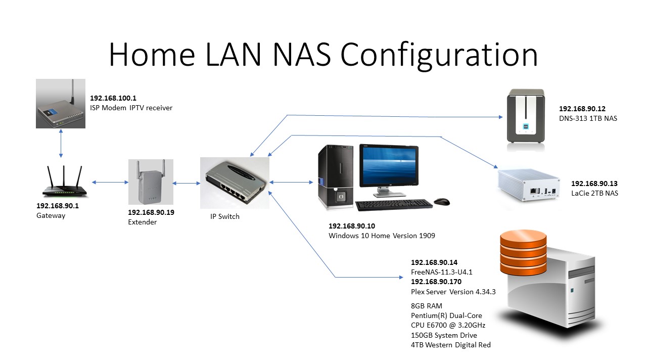

The attached image shows my LAN setup. Notes re this as follows:
1. I am able to map and access both NAS drives 192.168.91.12 and 192.168.90.13 from Windows Explorer
2. I was previously able to map FreeNAS 192.168.90.14/public and 192.168.90.14/private but something changed to prevent that connection
3. Plex Server, which is installed and runs on the FreeNAS Server, works normally across this LAN

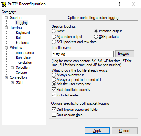

Right-click the upper-left corner of PuTTY to bring up the session menu. Select Change Settings... This will bring up the PuTTY config dialog.
Select the Printable output radio button, and click the Browse... button to tell PuTTY where to save the session log file.
