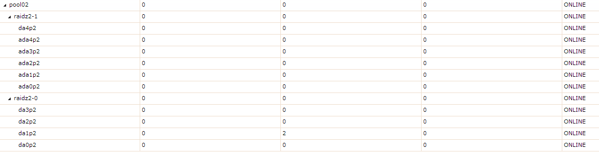

Thank you for the prompt response. You mentioned it is Offline, it currently states in the UI that it is online - i just wanted to see if that changes your diagnosis at all.
I have preemptively ordered another drive tonight to address this.
Thanks,
Chris
