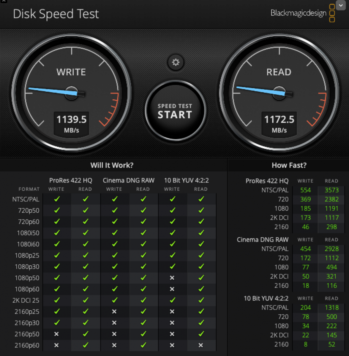

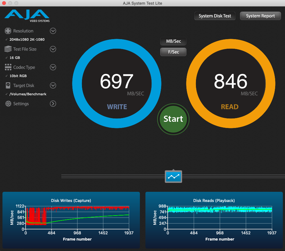

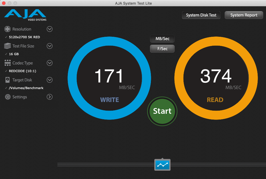

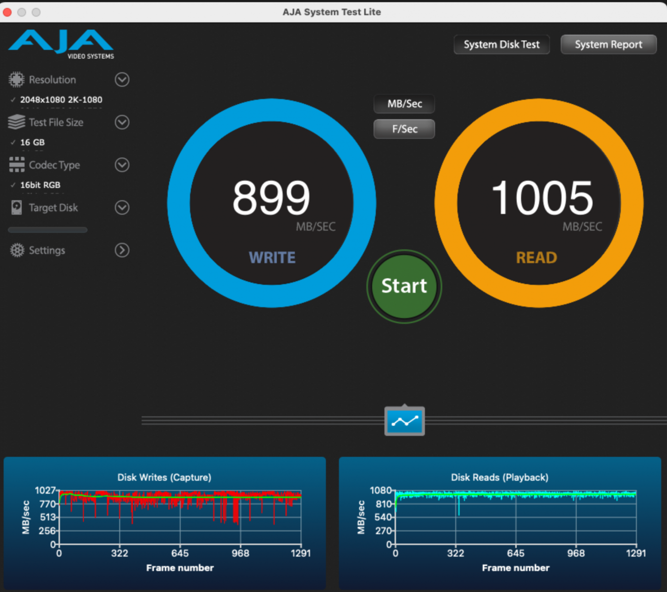

The network connection and SMB seem to be capable of high R/W speeds as this test with a very high zfs.txg.timeout shows.
I guess this is all written to and read from ARC:

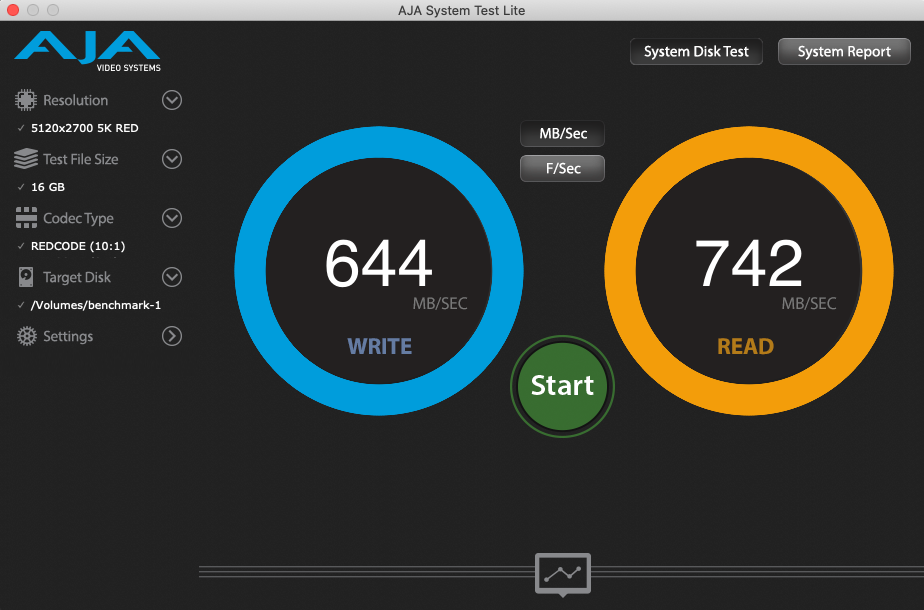

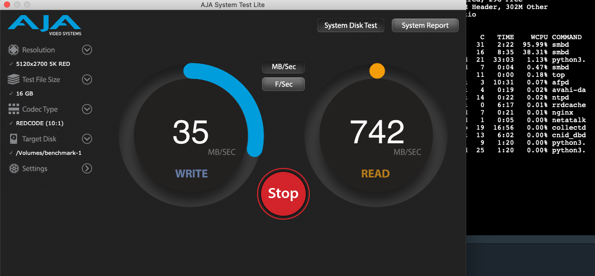

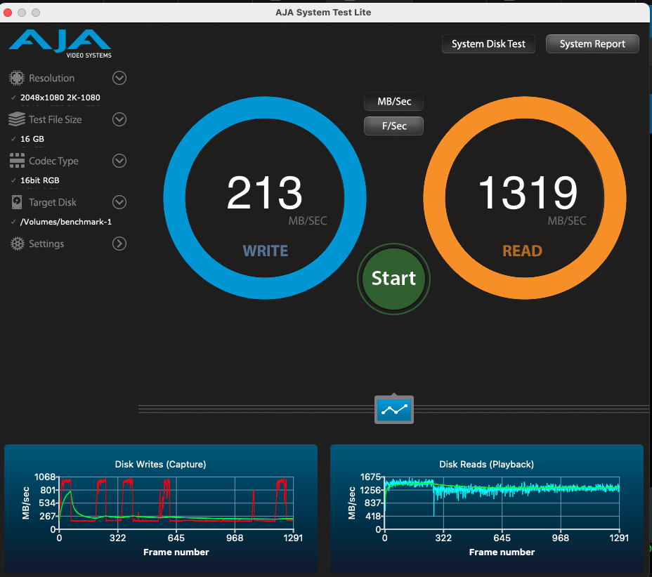

However. More realistic tests show write speeds more around 200MB/s
Again, this is changing a lot. Sometimes ramping up to 500MB/s or even more. Sometimes stalling below 100MB/s

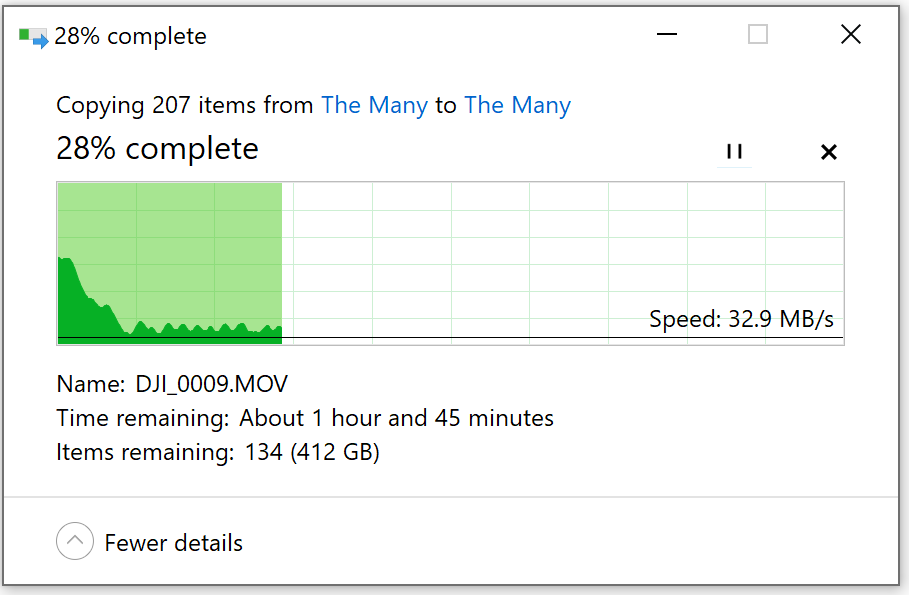

A real-world transfer that is running atm:

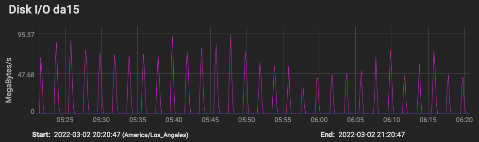

Disk activity during this transfer is very low with the disks mostly idle and short spikes every few minutes:

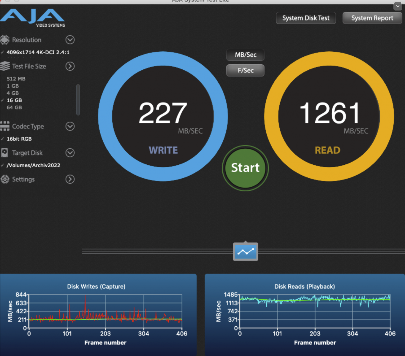

This is a test when speeds are inexplicably good:
Same test a bit later with nothing changed:
There is nothing else going on on the network.

When I test a single file with the AJA tool i get OK speeds
As soon as I switch to file-per-frame, speed drops. The speed falls directly proportional to the file size. smbd maxes out at nearly 100%
Exact same settings testing with AFP share. Speed is much better:
Also some real world copy tests with folders full of small-ish (8MB) files confirm these results.
Workaround for the moment could be to use AFP for all write-heavy stuff and SMB for read-heavy.

We were resorting to 10GbE and things were running fairly well apart from some problems when accessing directories with many files: Finder-browsing gets SMB stuck at 100% cpu - in otherwise almost perfect film post-production setup with Mac clients
Now I got an Atto NQ41 40G card and tried again with direct connection to the servers. Card has only 1 port so I aimed to attach the Mac to recent projects "workhorse" server:
Read speeds from the Mac to the Server are fine with around 1500MB/s.
But write speeds totally suck:
compared to 10GbE Connection:
Same shows with iperf tests.
