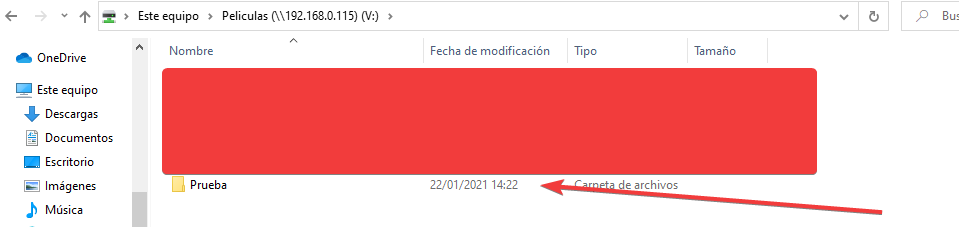

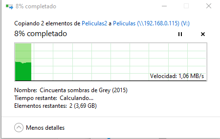

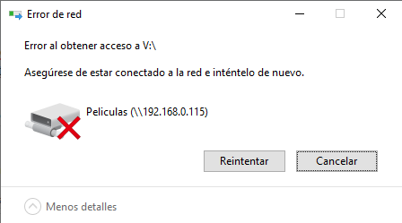

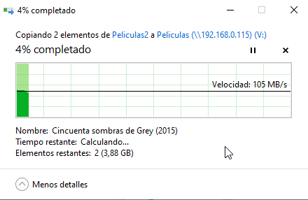

I have a problem when I try to share files with samba. I try copy files from my computer to TrueNAS on path /mnt/Vol_1_HD/Peliculas. I can map the path on my windows 10 and I can enter on the folder. I can start to copy the files, but 4 or 5 seconds later, speed descrease to Kb/s and it is maddening.

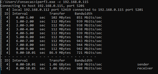

I check speed transference between two machines with iperf3 and these are the results.
I try copy files with WinSCP and use sftp protocol but its happen the same (speed decreases a lot of)
If I try to copy files on windows explorer windows displays the follow error.
But I see and create new files on folder.

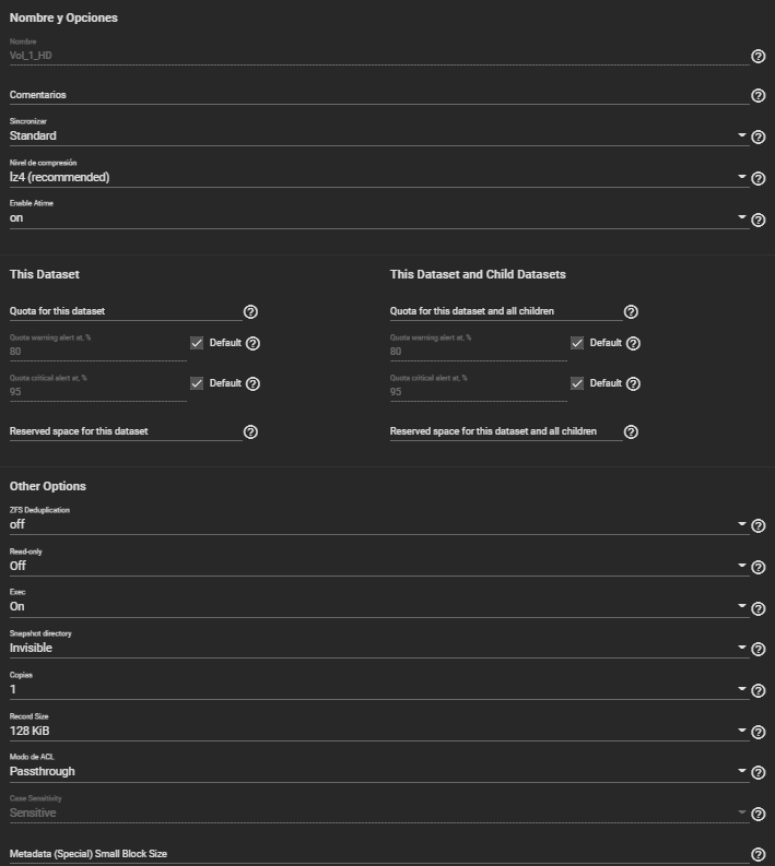

This pool is configured as follow:
The disk not form a part of a raid or mirror, is a single disk.

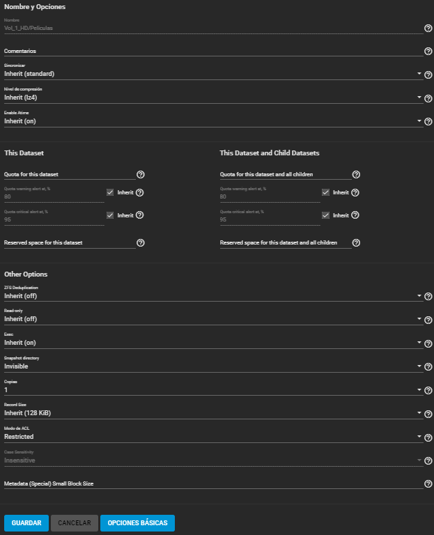

And the datasheet Peliculas,
Do you think that is a bad configuration? What do you recommend me?
Thanks for your help and interest.

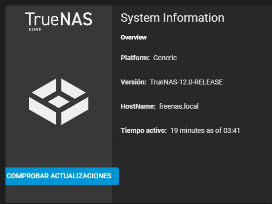

Hi @cobrakiller58,
Thanks for the info.
I downgraded it to 12.0
And when I try to copy the files, its seems that works because doesnt display any error but after 4 or 5 seconds decrease the speed of the transference from 94MBs to 0KBs.
The transference keep going but too slow.
It doesnt display any error, do you know what is happen?
Thanks for your answer.

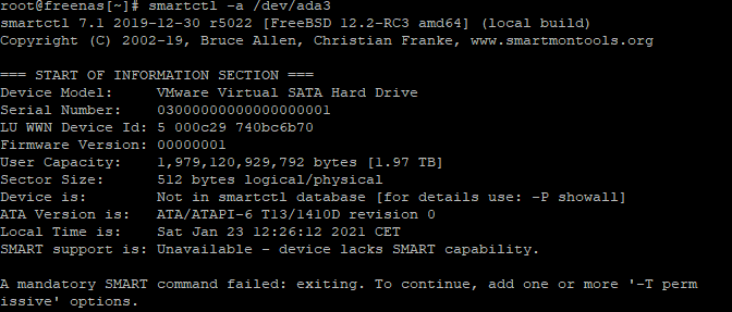

can you post a
smartctl -a /dev/ada3
pleas?
might be bad sectors on your drive.
the first few seconds are going to ram (arc) and then comes the slowdown

Hi @Hellione ,
This is the output of the command:

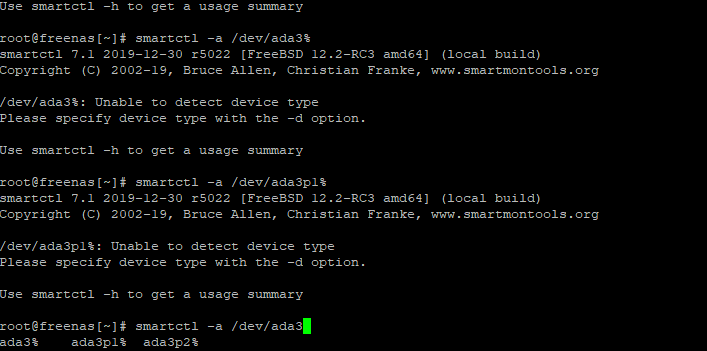

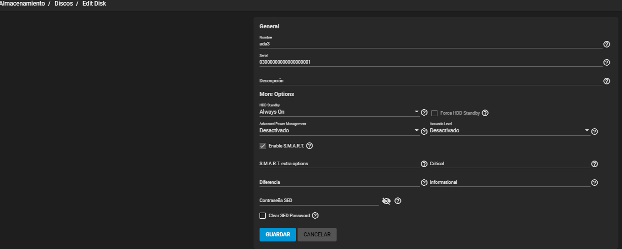

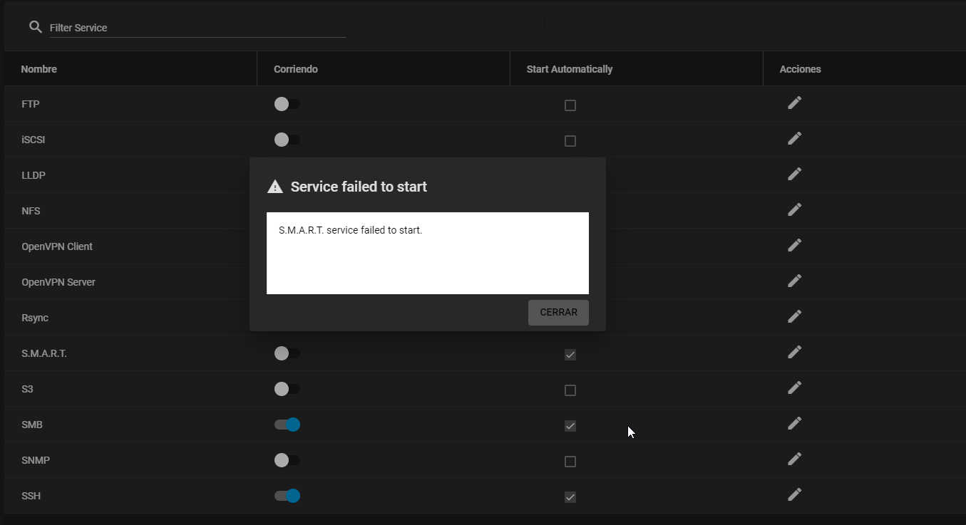

On the second screenshot, I show the different possibilities that I have.
I saw that s.m.a.r.t service on Truenas dont lets me start it.
Thanks in advance.

Hellione
Jan 23, 2021
55
hm ok i cant help you, this is an virtual esxi harddrive, and i have only experience with physical hard drives which are connected directly or with passthrough controllers

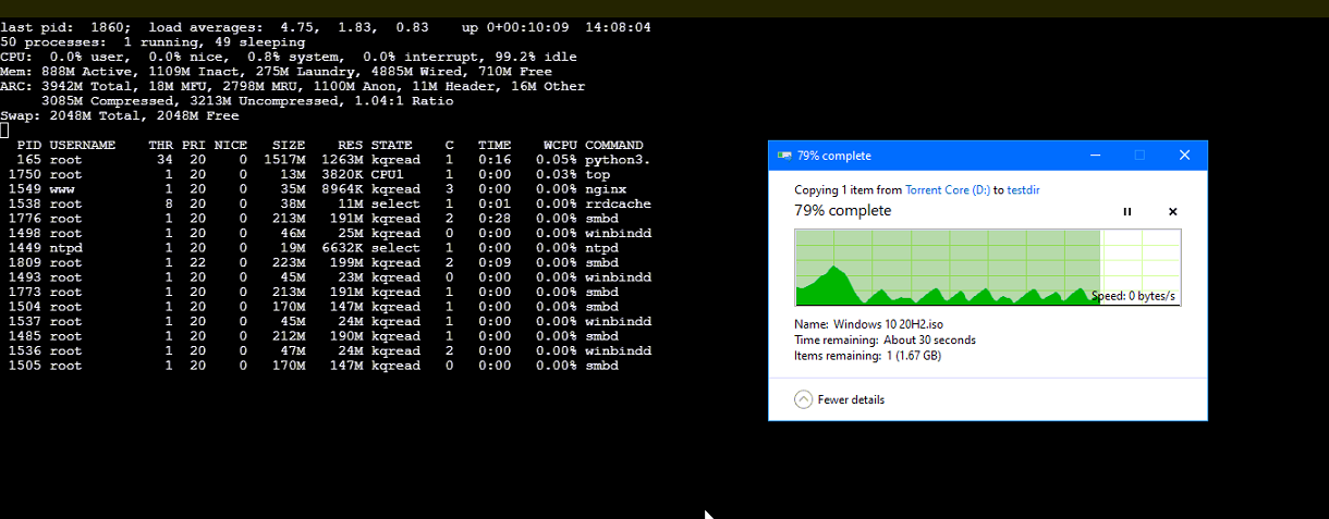

Jan 18, 2017
525

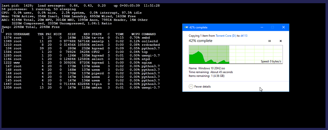

hmmmmmm do you have any other clients you can use to do the transfer to TrueNAS?
I just tried this and got similar results to you the below screenshot is a transfer from windows 10 2004 Ryzen 9 3950X to a hyper-v VM on the same machine 4 cores 8GB ram running truenas 12.0-U1
increasing the VM to 8 cores and 16Gb ram improved the transfer but it still dipped to 2MB/s
Transfer from a Ubuntu VM on another machine to the Hyper-V VM the speed was steady around 70MB/s increasing the receiving VM's cores and ram did not make a noticeable difference.
Below is a test to a new FreeNAS 11.3-U5 VM 4 cores 8GB ram on the same machine.
Honestly i have no idea what to make of this, post all the information about your setup and hopefully someone with practical experience with TrueNAS 12.0 in a VM can chime in. If that doesn't work the next option will be to file a bug report on Jira to receive advice from the dev's

I checked with transfers from other devices with other OS (android, windows and IOS "macbook air") both over wireless comunications @cobrakiller58 . Transfering 1Gb, from mac/windows device to freenas the result is the same, speed of transfer decrease when 4 or 5 seconds but it doesnt display any error and when I tried transfer data with my mobil phone I can do it with 8~9MB on wifi of 5Ghz and its okey.
Its too weird.
Thanks for your answers.
