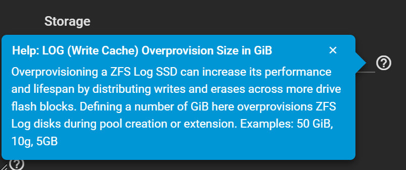

I'm actually still curious where the incorrect term "overprovision" grew out of. Typically when you undersize things, such as limiting a circuit capable of 1Gbps down to 900Mbps, this is referred to as "underprovisioning" in the industry. The incorrect "overprovision" seemed to pop up around 2015-2016 and may have come from the gamers. Either way, I talked about it X-provisioning often enough.
I probably have a bug number for underprovisioning on the FreeNAS bug tracker along with a blowoff closure from Jordan.

My own opinion of the "over-provisioning" naming is that it likely came from over-provisioning of the spare space. All modern drives, SSD & HDD, have spare sectors available for sparing out of faulty blocks.
I never really bought into partition based over-provisioning of spare space. It just did not seem like it would work perfectly. Now using the SATA protocol to over-provision does seem like it would do the correct thing;
