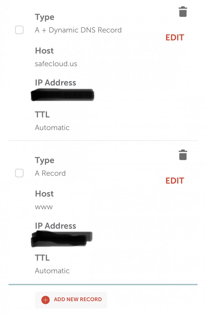

I think I might get my terminology mixed up. What I meant was the default router configuration will just use att DNS and not 8.8.8.8.

I’m not really sure either. But when I try to access my nextcloud by typing the address. It said ERR_NAME_NOT_RESOLVED (on my phone) and DNS_PROBE_FINISHED_NXDOMAIN (on my PC). I don't know if they both mean the same thing.
I’m not sure if I setup my domain name correctly. But this is what I have

15,504
I'm also not able to resolve that domain name. I'm able to resolve www.safecloud, but not safecloud itself. So that makes it seem like you haven't set up your DNS correctly.
I can't even resolve www.safecloud
It didn't even give me anything. Originally, I would just have to type in safecloud.us and it would work.
So what you're saying is that I only need to configure it some how on my domain name service provider which is namecheap?
I do have a dynamic IP address and I did set up a cron job for it to automatically update the IP when it changes. Should I need to update or change anything?
