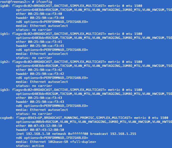

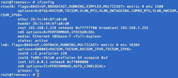

Frankly no, I'm not sure. Can you share a pic of your interface setup?

vtnet0 is the interface that the web GUI is on (I can tell that because the IP address is listed under that interface), so INTERFACE="vtnet0" in nextcloud-config.

This one's more complicated. The web GUI's IP address is 192.168.1.10 on this server:
It's complicated by the fact that the motherboard has four onboard NICs (igb0-igb3), but I'm not using any of them--I'm using a 10G add-on card that's at cxgbe0.

If you have trouble on the next try, let's just make sure the interface is specified correctly--post the contents of nextcloud-config (mask your domain name if you like, though be aware that it will be public knowledge once Let's Encrypt issues the cert) and the output of ifconfig.
