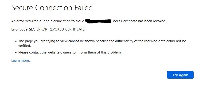

Yesterday some certificates got revoked by lets encrypt. Have you checked your certificates against non-complaince with ALPN TLS versions by letsencrypt? (https://tls-alpn-check.letsencrypt.org/)
You can do that with:curl -X POST -d 'fqdn=YOURFQDN' https://tls-alpn-check.letsencrypt.org/checkhost

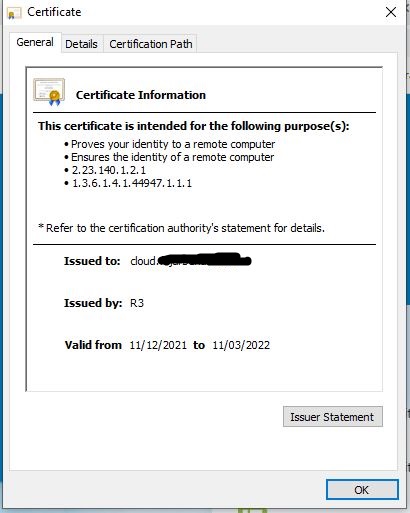

My nexcloud page certificated still revoked, what i have to do to fix it? Please helpi check the link that u gave, it said that I have to renew my SSL certificate ? please tell me what command that I have to run on my freenas to renew or reissued letsenscrypt SSL from my freenas-iocage-nextcloud .
Or any other things that i've should do ?
Please advice how to solve this problem.

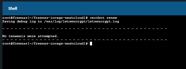

certbot renew
certbot renew , not working on my freenas nextcloud, it shown like below :I
Inside your nextcloud jail,certbot renew
No version of my script has ever used certbot. Old versions (when I was using Apache as the webserver) used acme.sh; Caddy now handles the cert automatically. And it will see that it's been revoked and renew it automatically.Inside your nextcloud jail,certbot renew
hi mr.danb35, please let me know how to fix the problem,No version of my script has ever used certbot. Old versions (when I was using Apache as the webserver) used acme.sh; Caddy now handles the cert automatically. And it will see that it's been revoked and renew it automatically.
uh yes, you're right. I assumed a non-ssl setup with your script behind a reverse-proxy that handles certs with certbot, like in my setup. @InGenetic, sorry that was bad advice.No version of my script has ever used certbot. Old versions (when I was using Apache as the webserver) used acme.sh; Caddy now handles the cert automatically. And it will see that it's been revoked and renew it automatically.
As I've said at least twice in the last few days, Caddy will renew the affected cert automatically. It will do this when it tries to renew OCSP and gets the response that the cert is revoked, which would ordinarily happen no more than four days after the cert was revoked.please help how to solve this problem.
No, that isn't what that says; it says the cert expires on 11 March. Certs are ordinarily renewed 30 days before expiration, so that would happen starting on 9 February--but as I said above, it should actually happen sooner.it seem the renewal will be at March 11, 2022

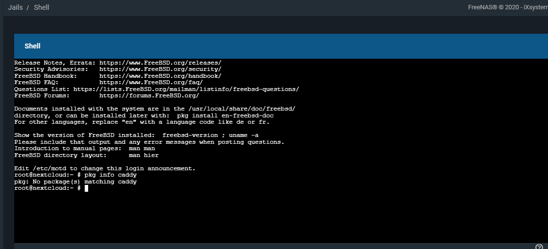

What version of Caddy are you running? From inside the jail, runcaddy version
Really isn't a supported configuration with this script, but some edits to the Caddyfile should do the job.What needs to be done to browse to example.com/nextcloud?
hi mr.danb35What aboutpkg info caddy

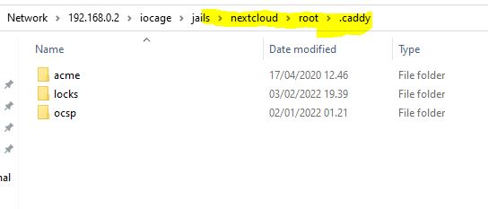

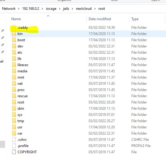

hi mr.danb35,In the jail, is there anything in /etc/ssl/caddy?
