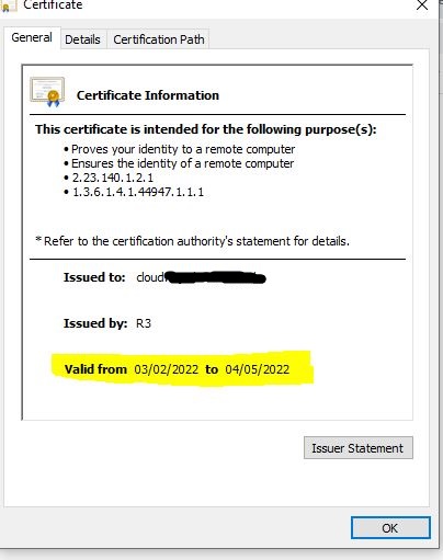

i can find that folder on windows explorer,
Well, it's a completely different folder, but it may yet be what we're looking for. Stop your Nextcloud jail, rename that folder to caddy_old, and restart the jail. It should create a new certificate at that time.
InGenetic
Dec 18, 2013
183
I don't think it matters how you rename it, as long as it's renamed on the TrueNAS machine.
Mr.danb35 ,
Really really thanks .. for your help , now my nextcloud page already has a new certificated, and running normally on mozilla browser and else.
and for the next 3 months , caddy will auto renewal it self as usual , isn't it ?

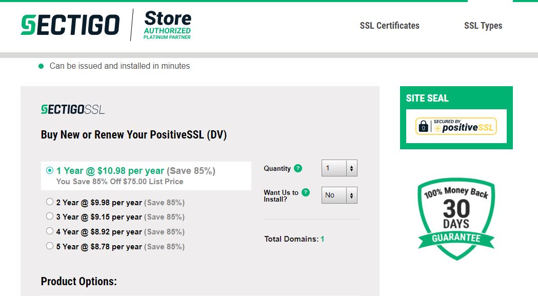

Hi mr.danb35 & all
i want to ask about commercial SSL , is that possible to use commercial ssl on my nextcloud using this script ?
just in case , one day on the future , we need to use commercial ssl for our nextcloud.
for example can we use this kind of ssl like below ?
and if possible to use this kind of ssl, please let me know about step by step how to using this ssl on our current nextcloud which we built our nextcloud using mr.danb35 excellent scripts.
