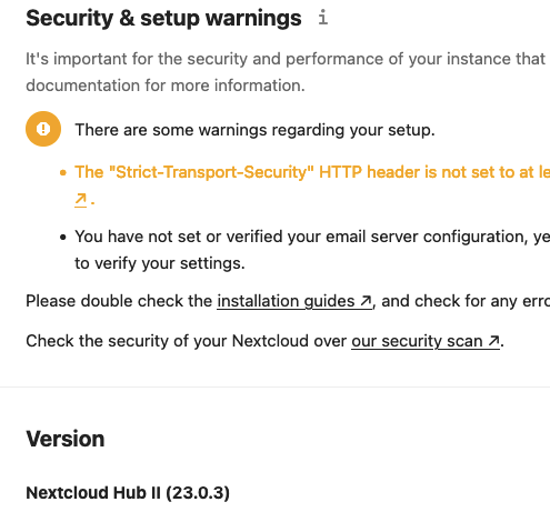

...I'm able to run the cron command without errors from inside the jail:
root@nextcloud:~ # su -m www -c '/usr/local/bin/php -f /usr/local/www/nextcloud/cron.php'
root@nextcloud:~ #
I'm able to run the occ command without errors:
root@nextcloud:/usr/local/www/nextcloud # sudo -u www php occ status
  - installed: true
  - version: 23.0.3.2
  - versionstring: 23.0.3
  - edition:
  - maintenance: false
  - needsDbUpgrade: false
  - productname: Nextcloud
  - extendedSupport: false
I'm able to log in to the system, and the admin overview shows no errors except the expected warning about HSTS:
Kind of hard to figure out what's going on when I can't duplicate it.
