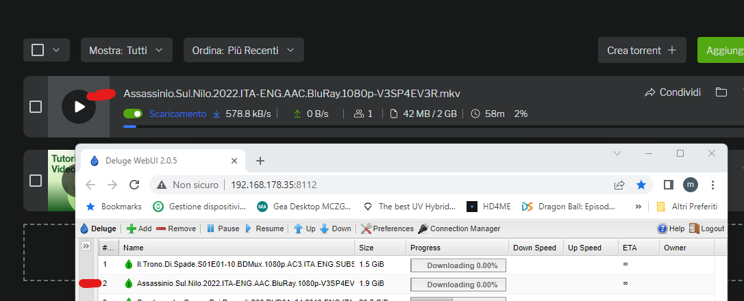

since I installed the NextCloud script Deluge it doesn't work anymore, is this normal? do i have to set something?

same torrent, one download with Deluge - fixed- , the other with utorrent.

Deluge is a Truenas torrent plugin. I wrote in this thread becaus the issue is appear after nextcloud installation

The best I can understand (and guess) from your very fragmented questions is that you're running a TrueNAS box, you'd installed Deluge (how?), it was working, including downloading stuff, and then after you installed Nextcloud using my script Deluge stopped downloading. Is that right? You can reach the Deluge UI, but it doesn't download anything.

that's exactly what happened to me. anyway I apologize if I wrote here but I thought it was the best place since the problem happened after using the script - probably at this point it was just a coincidence.
