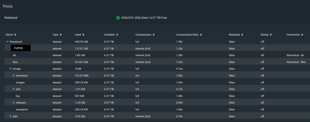

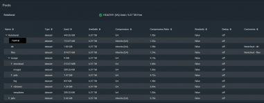

So In attempting to update php I've rather hosed an (admittedly) outdated NC 19 deployment. This was originally setup on version 15 or 16, with an older version of your script. Apache is the web server and it seems to be hanging on an expired Let's Encrypt CA.
So, I thought, let's just rerun the script. Then I noticed the dataset layout recommendations have changed a bit. Can you give some guidance on what I should add / modify so rerunning the script will pull in my data cleanly? I recognize I may need to reference an older version of NC for the install to not screw up database structure, and then upgrade in place from there.
Thanks!
15,504
According to this thread, you can move a dataset using the zfs rename command. So here's what I'd probably do:
  • Stop your current jail, and take a snapshot of it.
  • Create datasets nextcloud, nextcloud/config, and nextcloud/themes
  • Copy the nextcloud config file into nextcloud/config, and any contents of the themes directory into nextcloud/themes
  • From the CLI, zfs rename Rotational/db Rotational/nextcloud/db
  • Likewise, zfs rename Rotational/files Rotational/nextcloud/files
  • Your paths will now match the script defaults. You should be able to run the script with NEXTCLOUD_VERSION set to 19 in the config file. Set the jail name to something different, just in case this borks something.

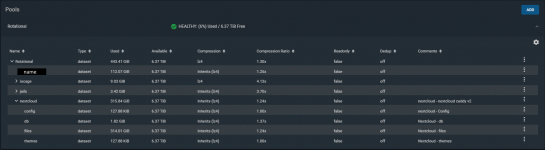

Super helpful info, thanks.
First try no go - looks like this... (log attached)
